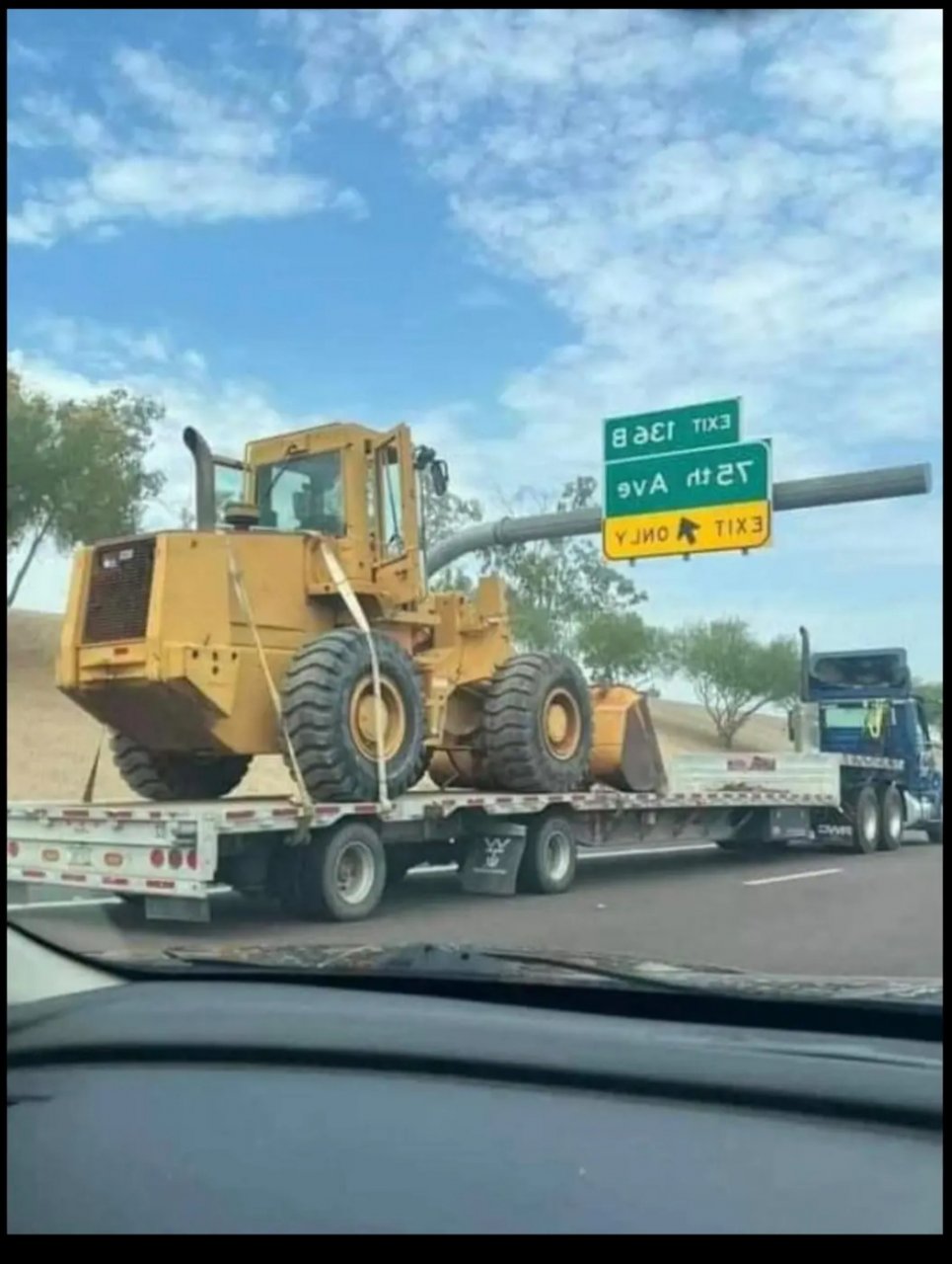

    Ummm....gonna need to see a cite, before I take this at any level of belief. 8.5' (102") wide is the max that I'm aware of without needing oversize permits. Correct me if I'm wrong, but I never took a load that exceeded trailer width without a permit. As far as I know, all securement and cargo need to be within those limits to haul legally without permits. Maybe some state has a different opinion?

    Not sure about legal, considering that the chains should have been looped around the spools, and the snap run on the top of the load. Most of those loads were bindered on the top, if it couldn't be kept within the trailers's confines regards width.

    I agree with most comments here, but aren't soft(ish) timbers an advantage in one way because the edges of the steel can bite down into them? A bit worried about 2 of them though as any slight movement of the load could have them topple, causing the chains to go slack. But needs must.
    I always used those kind of tighteners, mainly because I was never given ratchets (which are safer for the user), but I would never put 2 on one chain like that. Perhaps he didn't have enough chains. BTW in the UK even though small geographically, each region had a different name for those tighteners, 'dwangs' was one but the term I always used was 'sylvesters', but I have no idea why.
    But we never had those fixings that you have, just a 'side rave' with a 'chock rail' above it. There were rope hooks that we could tighten ropes to with a 'dolly hitch' but they were never to be used for chains to be attached. We always passed the chain over the load and under the chassis before securing with the whateveryoucallit.

    A soft timber will collapse under weight as you go down the road. This allows the chain to become loose. It’s even worse that it’s beams. The edges of the beam are all that is in contact with the timber. Essentially acting as the edge of a dull axe.
    The one chain, two binder is fine. He has slack between them, so if one breaks it won’t affect the other.

    I am not seeing any chains

    I think it was 6 ...
