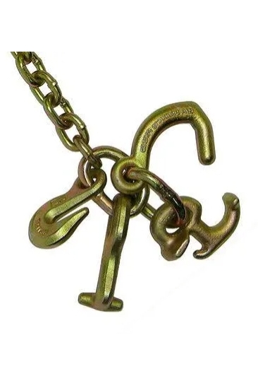

    Much like the current issue with short-strapping, short-chaining was also a problem. Our chain clusters looked like:
    There were oval holes in the frame designed for R hooks, Ford used same hole but allowed the T hook. The R is designed to spread the load of the chain tension, protecting the hole from damage. But it took practice to get good at the twist it took to get the R in the hole, and that was entirely too much work for the less diligent, and the "Any hook, Any hole" gang was born. J hooks being their weapon of choice, which put all the load at a single point of contact and would rip out the holes, especially when they often went in holes not intended for tiedown use. Frame damage is a total on new cars, and a no-sale on used when found in a post sale inspection.
    But it actually gets worse. 4 chaining a car puts a balanced load into the chassis, think pulling at 4 corners of a square. You start short-chaining, and now you're trying to twist the chassis. And you'd have guys sliding deck apart to use the hydraulics to tighten the chains, which far exceed the tension one could generate with a tiedown bar. They were literally pulling the frame into parallelograms, and permanently reducing frame stiffness. Chevy discovered it with a police Fleet that they could not keep in alignment, and they discovered one of the shuttle drivers was extremely over tightening with the hydraulics.
