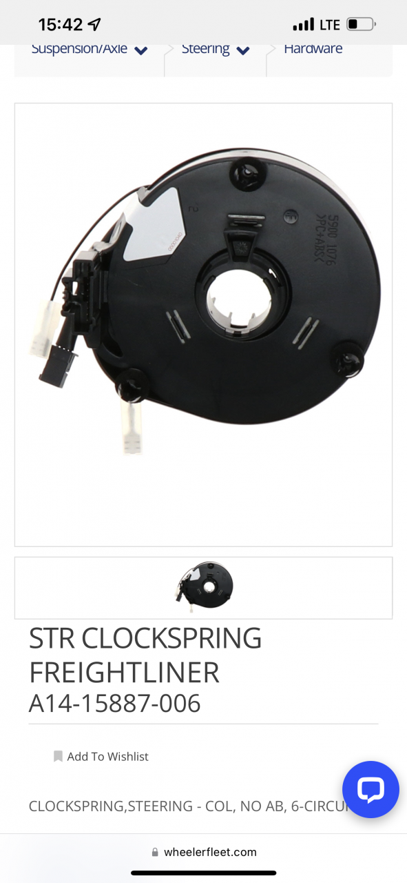

    Replace the disk under the steering wheel? Just had mine replaced. Same symptoms.

    Replace the disk under the steering wheel? What parts are they? Do you have any photos? Thank you very much!

    He is talking about the contact ring, it is a spring pressure part of the steering column, the electrical signals from the wheel are sent thru that.

    Is this the right part?

    Mine is an automatic freightliner cascadia!

    I just checked again. Could you please confirm if it is this part? Thank you very much!
