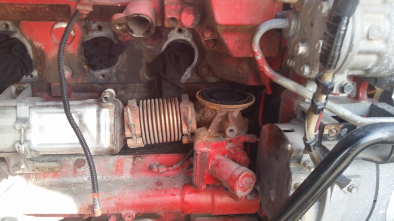

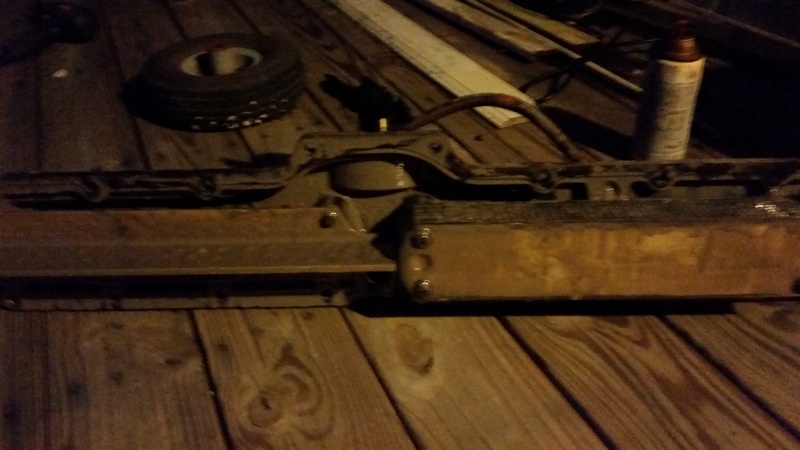

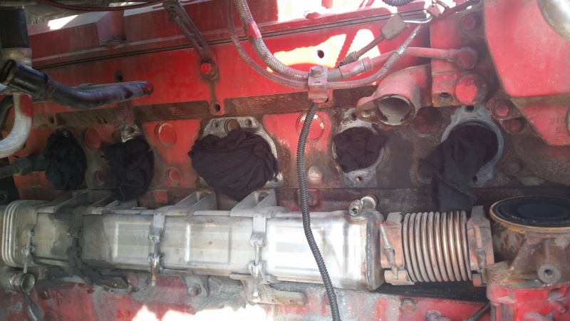

    Oh, btw for anyone who may be doing this repair in the future. Here are some photos:
    Turbo removed - getting ready to remove exhaust manifold.
    Exhaust manifold removed - getting ready to remove EGR cooler & valve.
    EGR bolts out, had trouble getting to come off the block, and getting the hose off of the back end. Picture shows soot covered egr valve in closed position. When the cooler pulled off of the block, I had enough clearance to remove valve from cooler.
    Finally got the oil cooler off. Picture is of oil cooler element still attached to oil cooler housing. Element is coated with oil and coolant.

    After looking at the pics again photo 3 - the bolts were not yet removed from egr cooler...I thought I had a pic of me struggling to get it off, but I guess I didn't...Oh well
