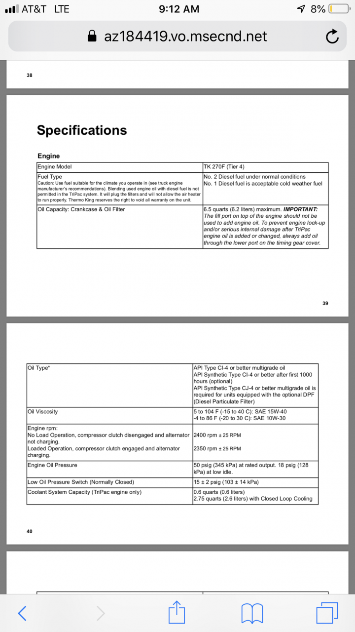

Thermoking evolution ran out of oil.

    I would Google the unit & get the oil capacity. You could also probably find if there is a reset button. I hope all goes well for you.

    This is a button, not a switch. It will look like this.
    If you can't find this reset on the wall just inside your access doors under the sleeper you need to reach down and pull up the sleeper and take a look just under that. These resets are placed for access but not all that easy.

    Looks like it holds 6.5 quarts. And it also says not to add it through the top.

    A little over a gallon, like 1-1/4, give or take.
