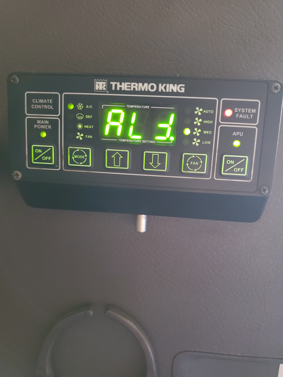

    upload_2022-9-7_11-44-26.png Would the corrosion left in the terminal of the 50amp fuse cause this after it runs a few minutes? With it running and the truck off Watching voltage on dash I was at 12.7v.
  4. Antinomian
    Antinomian Road Train Member
    2,117
    3,342
    Feb 17, 2013
    Can't tell for sure but it would be my first guess. The heat that melts those fuse holders comes from arcing, which is caused by the fuse being loose in the holder. That condition could still exist.
    Also, you thought your fan belt might be loose. I don't know about the older TK's but on the Evolutions the fan belt has to be really tight. But you should hear it squeal if it is too loose.
