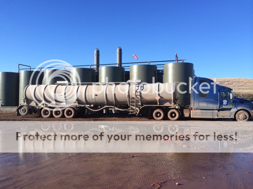

    George, In your photo I see a pair of VRT's behind the tank.....are you saying these tanks are holding pressure?
    If so something is very wrong. On the ground near these towers will be a small skid with a short column and some piping and a couple of electric motors. It should be running. Report the failure to the pumper or owner.
    There should be no pressure on this setup.
    Stubby T Slapnutt Thanks this.
