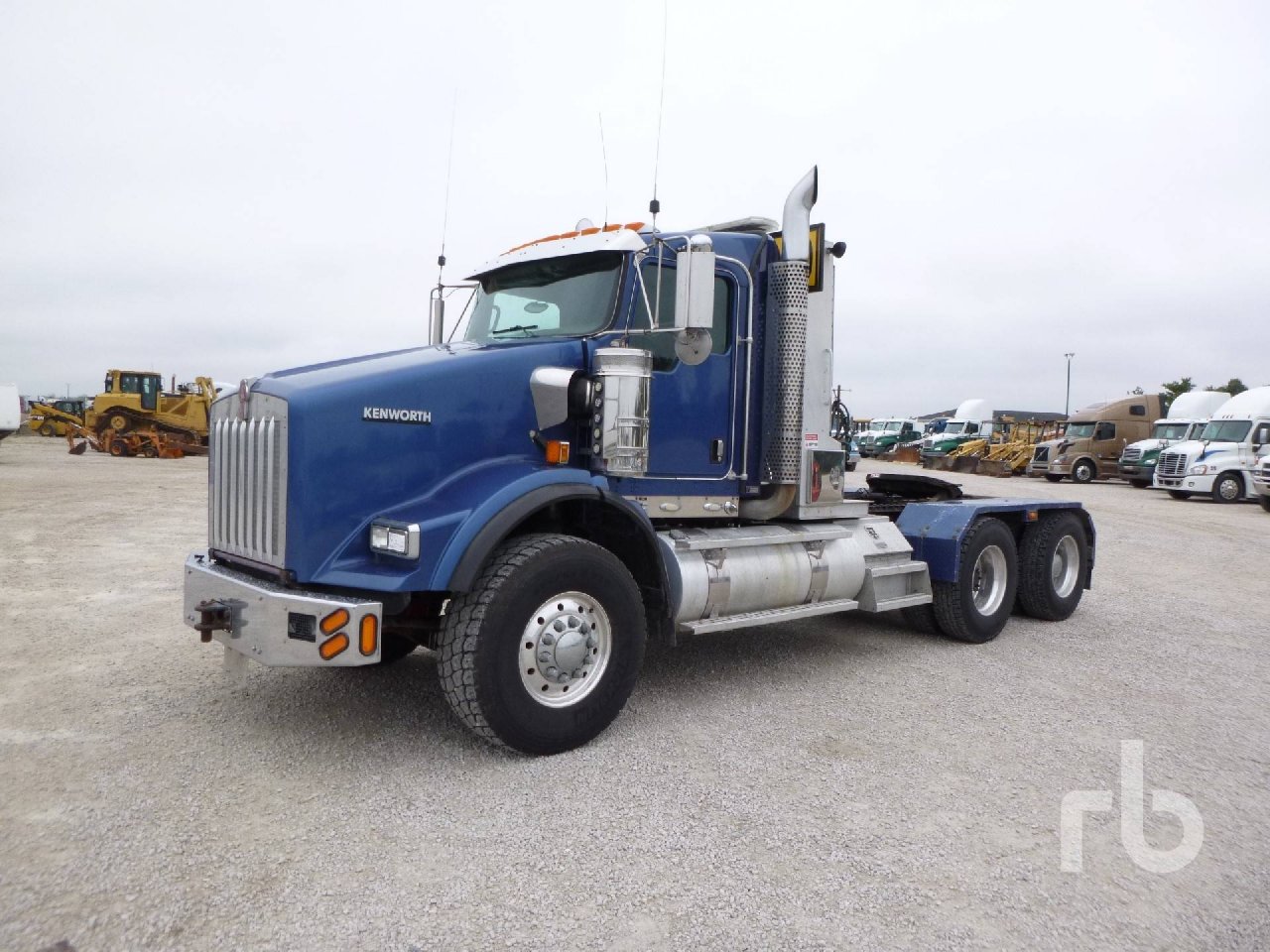

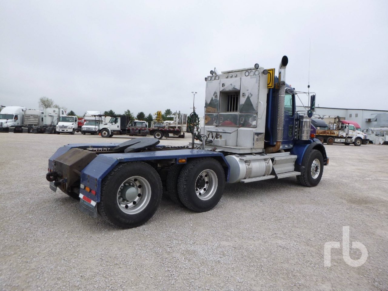

    you mean close to 19-20,000? or to 23,000?

    Sorry, close to 23000.

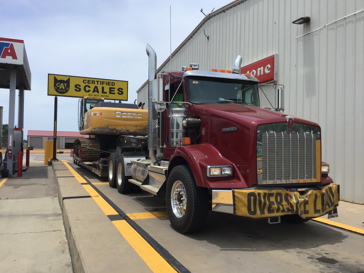

    Mines a T880. I’ll send one of the 800 in a bit.

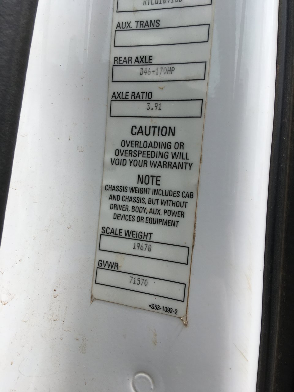

    I doub it’s that much but maybe.
    I wouldn’t go by that, the one in my picture said 21,752 and the Cat scale said 23,400.

    4D222C8B-58A1-4AFF-87CA-E919CBC86B78.jpeg It hasn’t seen 19000 in its life. Lots of stuff on there to add weight, including the fact that it’s a heavy spec tractor. If it’s got a wet kit, and if it’s a 2008 or later with a suck box, you’ll be lucky if it’s less than 22,000 imo. But what does it matter if it does the intended job well, you are permitting for heavy hauling anyway and You can get a lot of weight on that heavy front axle. In my state I could balance the load and fifth wheel slide and axle that thing out legally at 126,000. Take a look at my newest toy.
