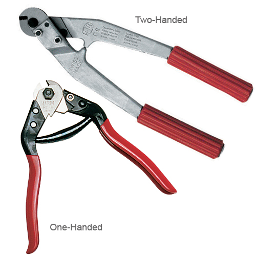

    For plastic seals you can use a knife or side cutters. For cable seals get a pair of cable cutters and for the hammer I find that plastic dead blow hammers work best. The rubber mallet tends to wanna bounce back where the dead blow transfers the shock to the trailer to help loosen the sticky product. I haul flour 5-6 days a week and our company issues us 3 pound orange hammers from harbor freight. They are like $10-15 and have a lifetime guarantee.
