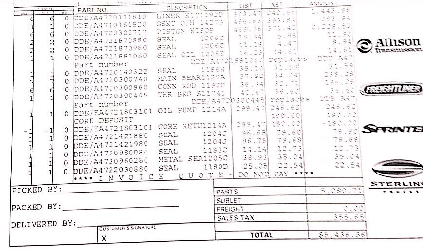

    I have a dd15 engine. This have 1.2milion miles. The truck in great shape. I own it longtime ago. I have new Starter new fuel pump new injectors new waterpump and I wanna rebuild the engine. My mechanic said he can give me 6 month warranty or 80 000 Miles warranty. I may wanna get new turbo and new air-compressor. Overhaul kit is 6500. Labor 6000. So I will end it up with $16500. It’s a def free engine. I just don’t wanna waste 60k for a truck with 500k Miles. On that half way trucks need a lot of work I only wanna drive 2 more years. That’s all. Like 200k. What you think ? It is good idea ?

    Actually warranty is 100k but this is usa so I always think 20% is always lie. Real parts and labor is :
    $5500 labor
    $5800 parts
    Warranty 100k
