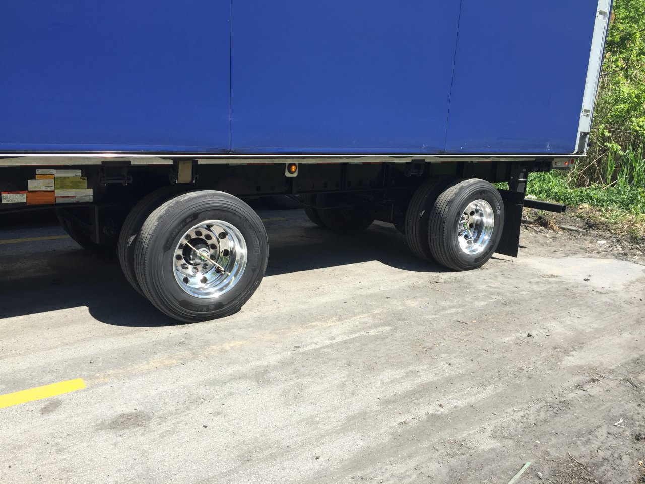

    Without blowing up my spot too much.. Friday I was looking at a couple lot units at my local dealer. They have j hooks, no chain pulls, and the placement of some of the stops on the winch track are set up so that the winches don’t get right over the tires for clearance. Plenty of times the loads I’m hauling are right to the edge of the deck, and therefore a ratchet won’t fit inside the kit at the height that the ratchet would be.
    However, the tie bar on these units is waaaaay inboard. Like 18”. Which had me thinking if needed I could run the hook end on the winch side and the ratchet on the tie bar, way underneath. I don’t like that idea for all the obvious reasons, but it would work in a pinch. I’ll have them put another tie bar on the winch side way underneath as well to facilitate doing it on either side when it’s in for more toolboxes.
    I’m thinking on the next trailer I order: I may forgo stake pockets all together- all spools front to back. A lot of what I would use a open flat for, the straps go across one side to the other with 3-9’ of forward to back between the hook and winch. Also I think it’d be a lot handier having more options therein for a chase strap out back or a toe strap on the nose in the rare times I could use one.
    for a Connie: least for what I do, it’s handier to be able to run a winch at ANY spot front to back because of that lack of ability to put a portable ratchet inside the kit; and have lots of winches for different options/ multiple layers, crossover tie backs, belly wrapping etc

    I used to pull this QuickDraw on a Utility brand combo full time. You could run a full height winch directly over the tire and not have any rubbing issues. Out of habit I would run them s few inches forward or aft of the tire.
    I like the idea of all spools. You could even add a bolted on tie bar directly over the axles yourself. A few grade 8 bolts and a piece of flatbar. That’s the only place I would see the need in my opinion.

    The winches slide over the tires with plenty of clearance on my other flats that are Transcraft; these wagons are Manac and the winches will slide over both axles (just clears it) on a closed tandem or the front axle (just) on a spread, but not the rear. Which is weird bc my Transcrafts have the same Hendrickson intraax suspension.... (full store winches bc they are the only size offered all galvanized that I’ve found)
