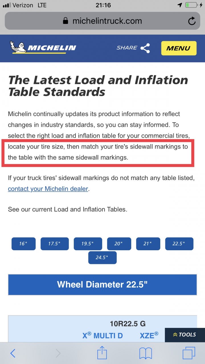

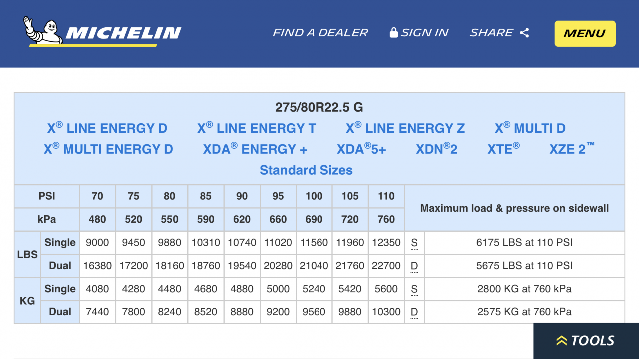

    Now, Michelin’s website has “load and inflation tables” where you can find the best psi for your tires based on the operation of the tire (single or dual) and the load the tire will be holding. There are different tables for different tire sizes and models. You know you are looking at the correct table for your tires if it matches in size, model, and max load/pressure on sidewall (images below).
    Load & Inflation Tables | Michelin Truck

    Michelin isn’t very clear on if tires have max air pressures. It just seems to be implied that if you put 11,960 pounds on two steer tires (image below), you want to have the tires at 105 psi (no more or less). Additionally, we know there is such a thing as over-inflation tire wear, so there must be a psi (based on load weight) that if exceeded causes irregular tire wear. One way to know if you are over-inflating it is if the very center of the tire tread depth is less than the lines next to it.

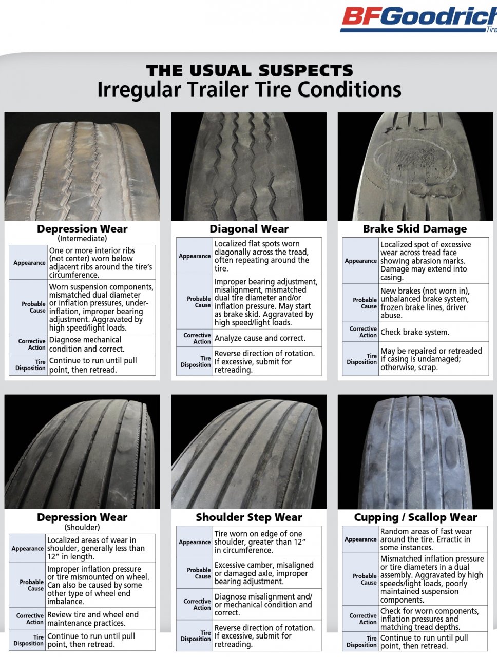

    I found this website with pictures of truck tire wear with explanations and solutions. There are three different documents (steer, drive, and trailer).
    Tire Wear | BFGoodrich Truck Tires
