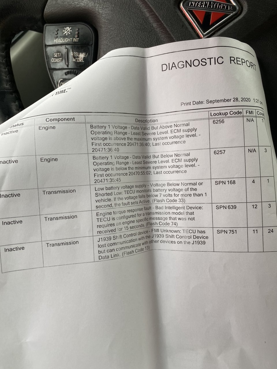

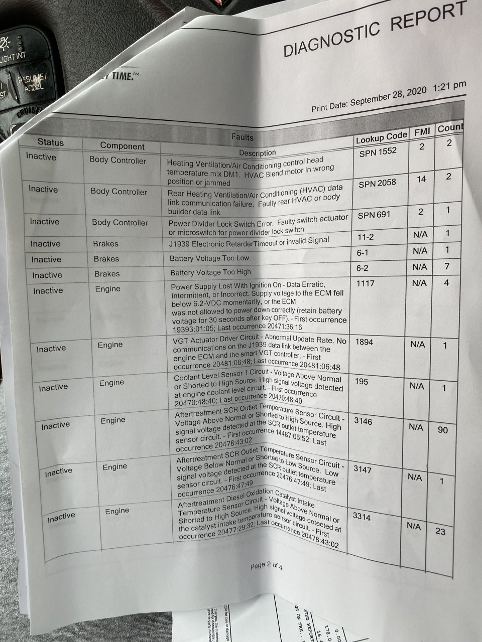

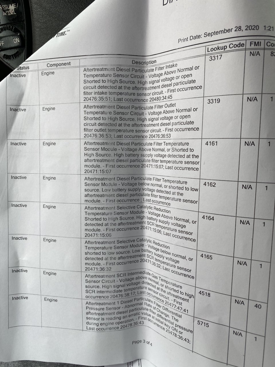

    Just purchased a truck and I’m having inactive codes for body controller transmission and engine , all voltage codes
