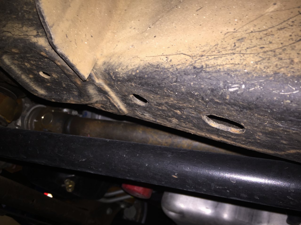

  6. Bdog
    Bdog Road Train Member
    1,057
    877
    Nov 6, 2014
    Thanks for the reply. Not too late. I have yet to haul it yet though I did crawl around under it some more. Up front I think I found the holes in the bottom of the frame right behind the tire. The frame is fairly thick here but they don't seem to be reinforced. On the back I can't find them, maybe they were on the receiver hitch which I no longer have because it has a flatbed.

    Rolls Canardly here,
    In your case these two slots would be the front tie-downs, just insert and turn and its locked.
    I did like Big Perm's suggestion above, the axle strap ratchets will pull everything tight up front.
    These are the slots I put my deck chains on for "safety chains."
