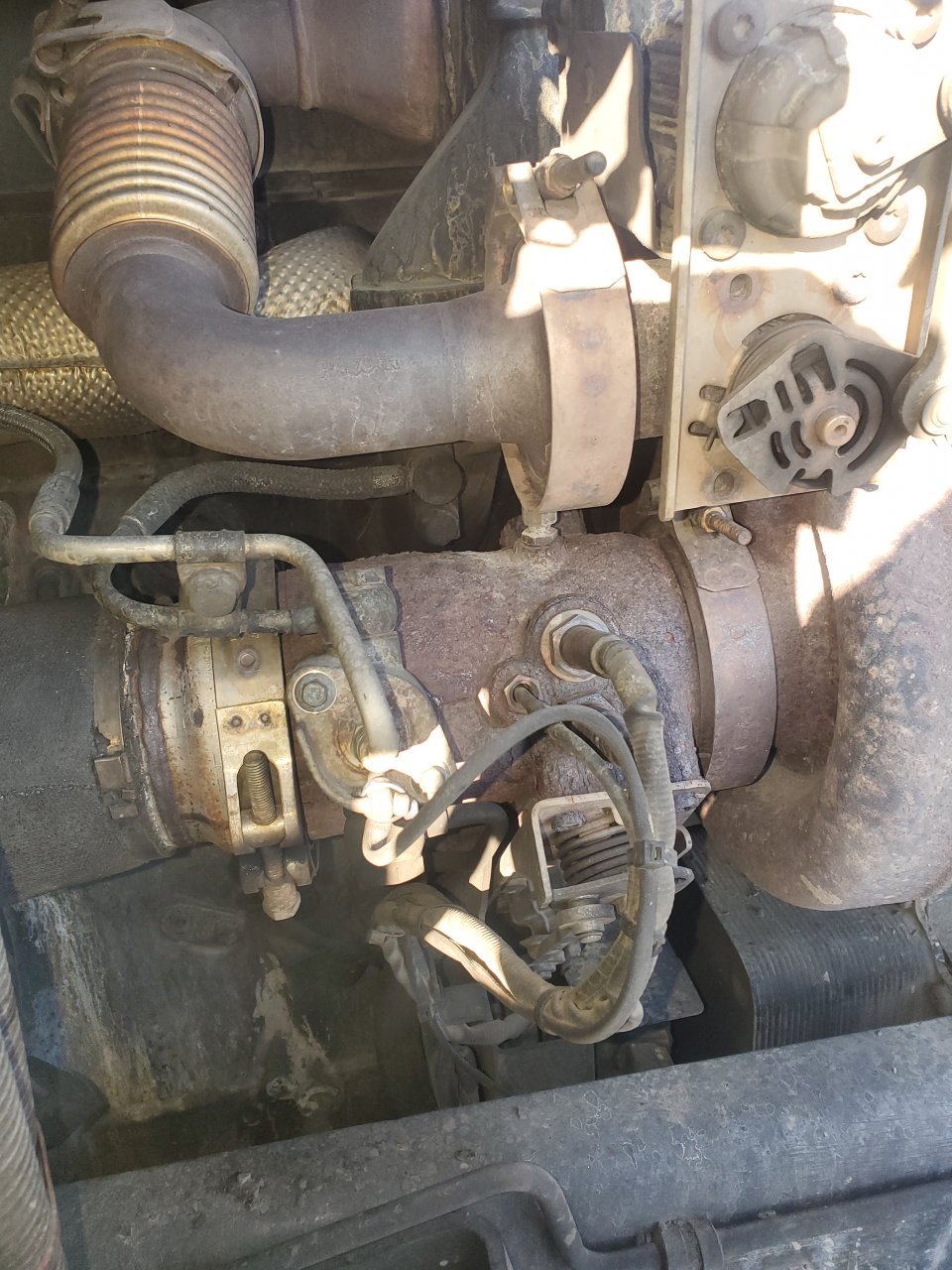

    Few times now checking for leaks while it was smoking. Side panels off, even crawling under the truck. All the clamps are tight and there's no soot/dirt build up indicating a leak.
    Only leak I've found so far was a small one in the engine, seemed much to small to produce the billowing smoke.
    This bottom valve between the turbo and exhaust (egr?). Small amounts of smoke puffing from behind it under the pipe.
    D.Tibbitt Thanks this.
  5. D.Tibbitt
    22,217
    152,859
    check those clamps that connect the pipes together... best way to check is after ur truck has been sitting so all pipes are cold.. then startup and spray with soap and water and watch for bubbles.. you can still do it when its hot but the soap exaporates to quickly
