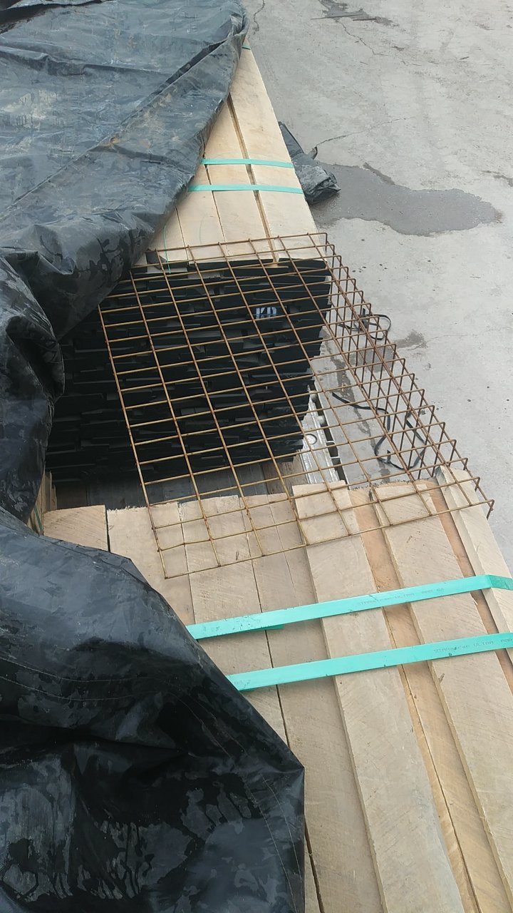

    Found another reason to love my brick screens. Flush tarp bridge.

    I s
    I see where that would work good but would it wear the tarp through quicker where it rides over the edge or would the corners of the lumber be worse on them ?
    FerrissWheel and Cabinover101 Thank this.
  7. FoolsErrand
    FoolsErrand Road Train Member
    2,877
    12,170
    Sep 15, 2017
    the lumber is sharper than the screen actually.
