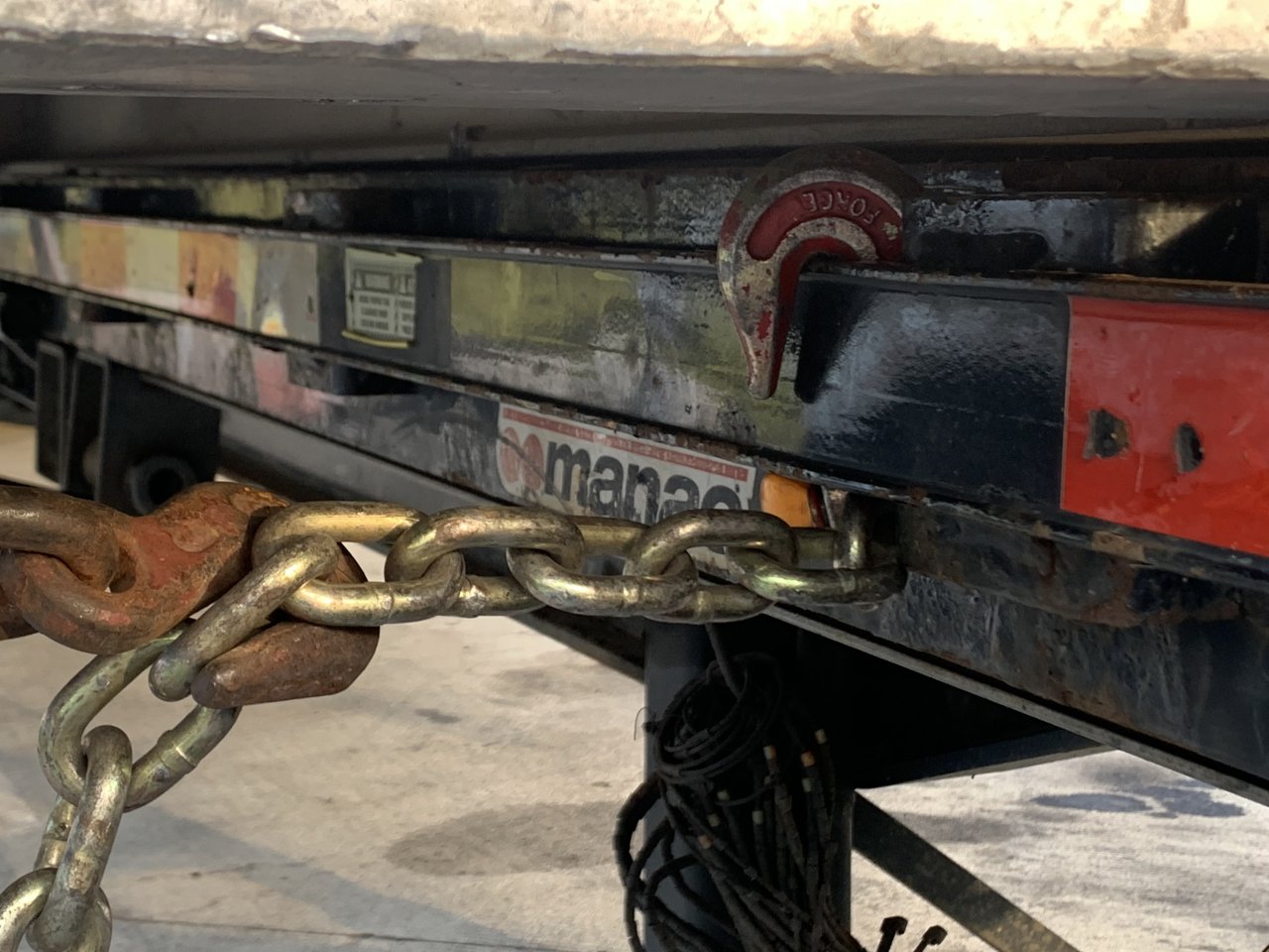

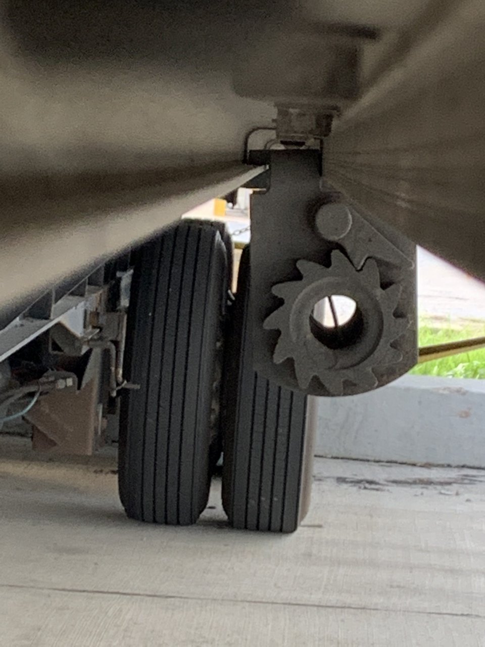

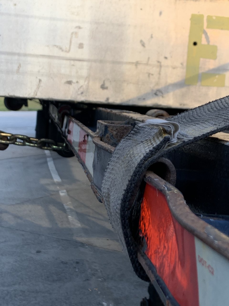

    Yes typically. Most of our guys just use short 4” straps to where I have my ratchet binder hooked. 4 per pallet. It works but I prefer ratchet binders because I can actually shift the load around to get it perfectly straight. There’s also roughly $1M worth of freight on each pallet, I’d hate to have a piece of road debris or a sign cut all my straps on one side.

    Think you addressed it in your following post, but hooking to the steel rubrail is at least better than the aluminum ones, deformation vs tearing...
    Like the way you grab the winch with a short chain though. For my preference, i like the tie bar thats *sometimes* bolted or welded past the LL track though

    Try putting the chain all the way under the frame and around a pocket or a couple spools with the binder connected to or close to the load
    Consider steel corner softeners on the framerails.

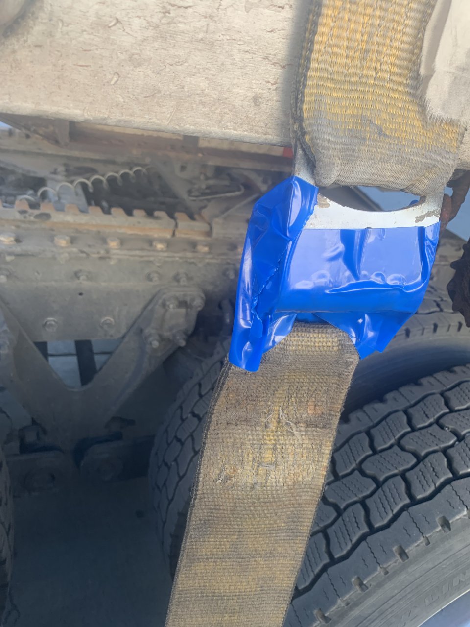

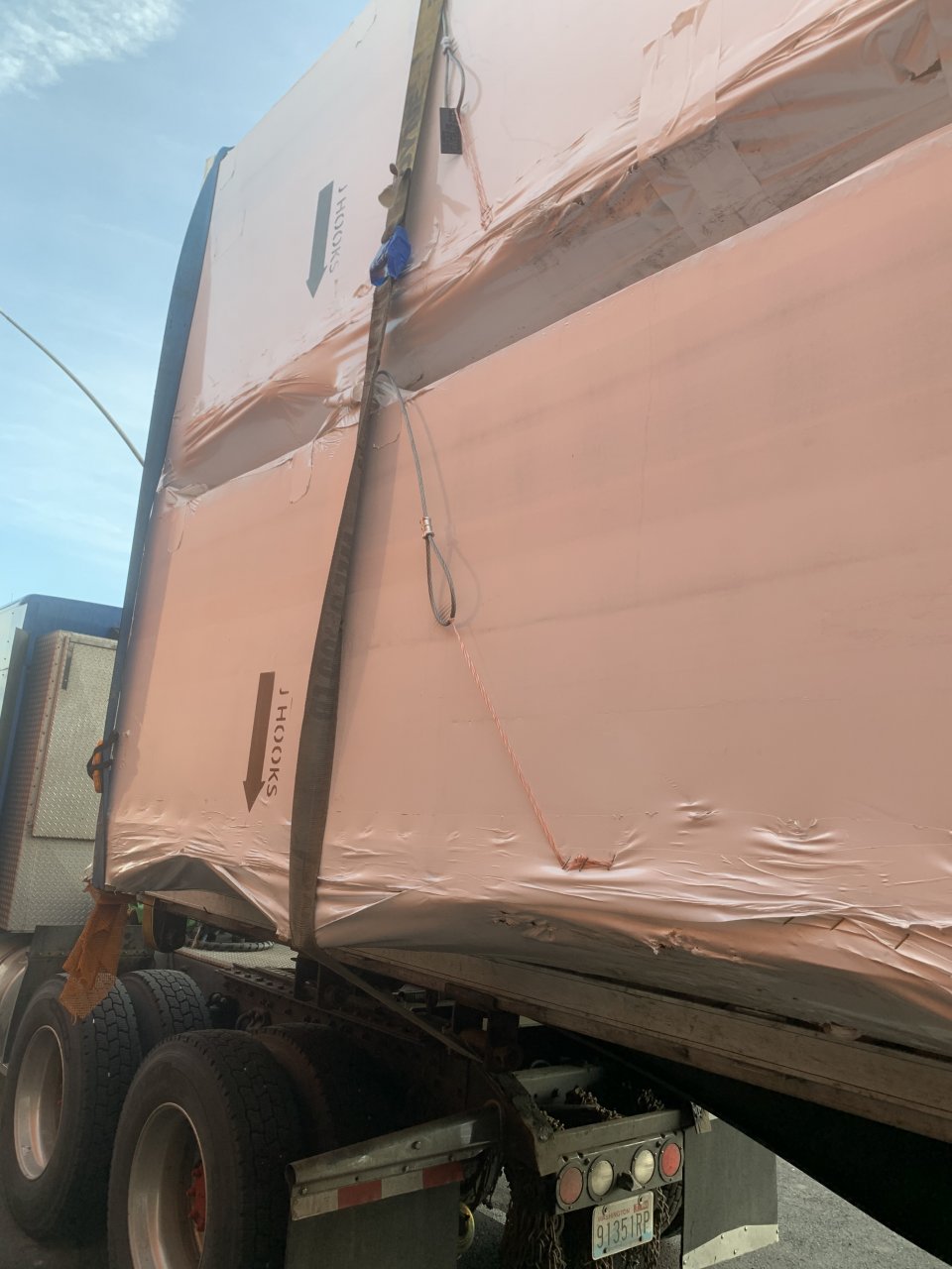

    I carry 6 40’ and 50’ straps. I needed 8 for this load, so I took a 30’ strap and one of my short 8’ straps, taped the hooks together and put each end in a winch. The tape just keeps the hooks together incase the strap gets loose. EEE2C5CE-49B0-4D69-B8B4-AE033AE3F53A.jpeg 77F6EE6D-826C-4FED-92A7-498ED523EB80.jpeg
