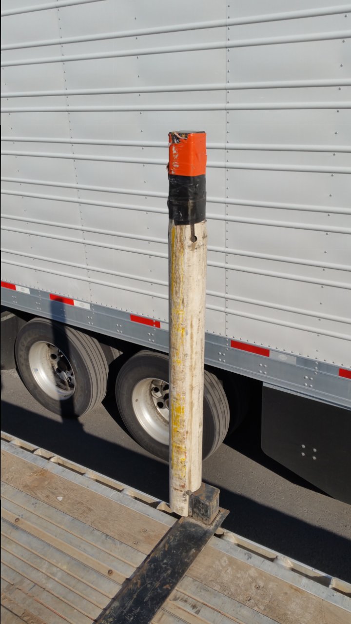

    Rather than use the PVC "corrugated" pipe to cover my pipe stakes, my brother came up with a great way to cover pipe stakes using solid white PVC pipe. At the top you cut four notches and form to fit at the bottom. Be SURE to drill round holes before making your straight cuts to prevent fracturing later.
    To install we use two c-clamps at the top, then Gorilla tape over that. I add orange Gorilla tape at the top of the stakes to help forklift drivers see them at night.
    These have lasted for well over a year. On occasion we may need to replace a c-clamp and will do another Gorilla tape once every other month or so. The huge advantage of this system is the PVC cover won't budge, allowing pipe to slide easily without lifting the PVC cover.
    tsavory, barroll and MJ1657 Thank this.
  10. Espressolane
    18,850
    118,438
    Take that one step more. Depending on the pipe stakes used, make a couple of cross drilled holes in both parts and use a long lag bolt, washer and nut. No more C clamps lost.
    When not in use as a cover, the holes will keep the bolts from going on vacation to some unknown place.
    barroll Thanks this.
  11. Lepton1
    Lepton1 Road Train Member
    12,647
    25,593
    Nov 23, 2012
    Yukon, OK
    I'm not sure how well that would work. This kind of PVC easily shatters with any stress on a small area. I think any significant uplifting on the PVC during loading or unloading, when the forklift driver is backing away and spinning two ton collars against it, might fracture the PVC. Using c-clamps spreads the holding power around the entire post and circumference of the PVC. The duct tape (or Gorilla tape) adds additional holding power in the four gaps and protects the c-clamps.
    One thing I've done is started to place the c-clamp screw ratchets on the side that will never be inward toward the load. Since then I've never had to replace a c-clamp.
