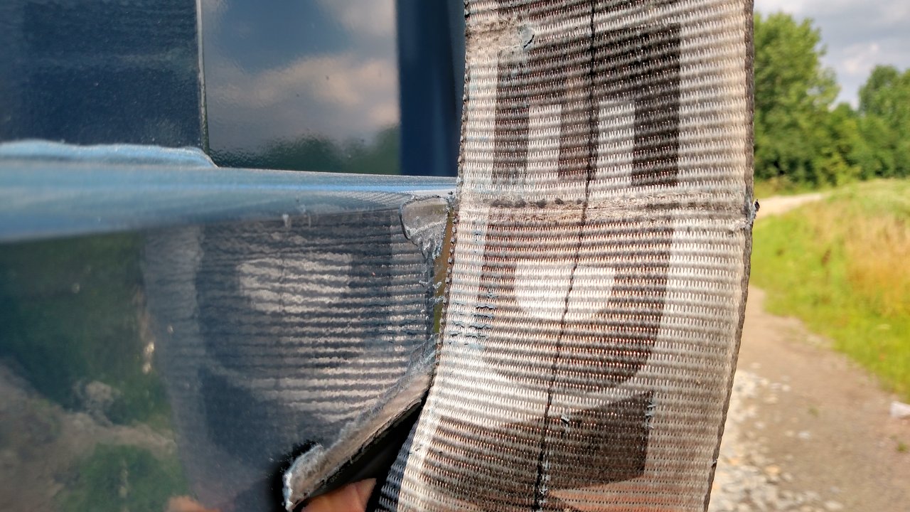

    IMG_20180705_115651606_HDR.jpg Thanks for trying to help me with my strap issue.I believe I just solved the mystery of cut straps, and can't believe I overlooked it. But with another set of new straps and inspecting them on removal instead of when about to use again I see the problem. My Fontaine steel deck flat has a sharp corner edge and I always try to run straps inside rub rail which sets them right against that edge

    Perhaps that's why a lot of the steel trailer drivers wrap around the rail instead of inside the rail. If you want to stay inside the rail you might consider padding with something like cut lengths of old webbing or fire hose.

    I guess so but now when when I looked at pic again I realized that cut was from flat side of dumpster box I had on trailer apparently I'll have to cover every inch of strap that even touches load, but nobody else seems to I just don't get it
