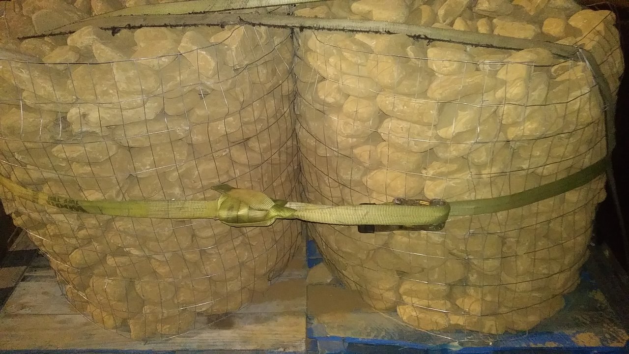

    My worst stone product is baskets of river rock. Theyre palletized round fence wire baskets and you cant keep them tight, the load vibrates down, compacts and loosens. The baskets bulge out as you continually retighten. I keep my best straps on the front [since theyre the first thatll kill me in a wreck] and i criss cross that pair since round baskets want to drop a strap over the corner unless youve got them lasso'd at center. Double strapping the center too tight will just bust the cage open or crush it down and let stones dance out. Im gonna cut some plywood strips to try spreading the force across more stones soon.

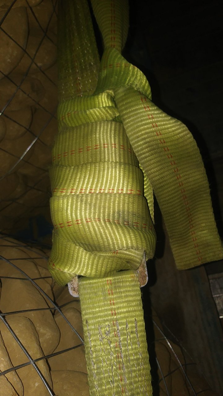

    Another trick i never see other drivers do is to wrap a regular ratchet strap around the belly of two baskets like a corset to keep them from bulging over. You link two J hooks hand in hand then use the slack to wrap the j hooks into a splice cover, starting by feeding through the gaps in the hook eye where the factory sew the strap onto the hook.. Hard to explain but i have never had this pull apart or shift. I dont think it counts as securement and its more work for me but easier than apologizing at someones funeral when a basket splits. I do it on front and rear where the double strap is really crushing the cages down, after ive drove a few miles to settle the load.
