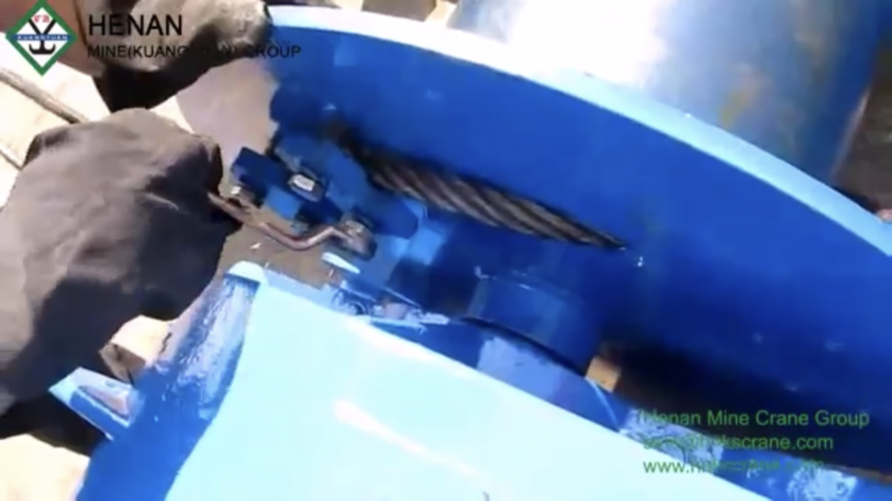

    A crane drum absolutely relies on friction of the wraps, the mechanical connection is just to keep the cable in place to start that wrapping.
    Here’s a screen shot from a video showing the process of wrapping a drum. Do you think that little block tightened with a wrench is going to hold that cable? Of course not, that’s why the manufacturer has recommended minimum number of wraps that have to be on the drum. The crane drum is 100% reliant on friction.
