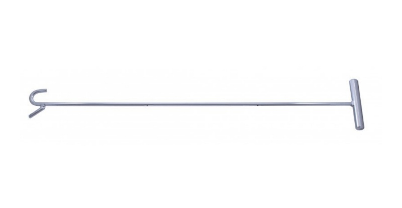

    NO. That is the worst idea if you ever want children. Feet don't have control over the bar like hands do, and it WILL slip and nail you right in the family jewels.
    Longer bar is the only solution. Extra leverage advantage with less work.
    Arm strength isn't what closes a winch off that last click, it's body weight, and as a 260lb man, I don't ever have problems opening a winch I didn't close. And if you use arm strength on a regular basis, you will notice shoulder problems long after they've caused serious ligament damage.
    Grab the bar with both hands, brace it against your body and squat. Use your whole body weight and all you muscles to your advantage.

    Gain leverage with a longer bar. When bars begin to break then attack the pawls inside the side cog wheels of a strap handle using a bar of strong metal and a mallet. (Not hammer, you can spall off metal which will usually try to get into your eyes.)

    Actually, upper body strength can allow you to use your weight more effectively. I used to put the bar in a slot that made it stick up if possible, then I would move my body back and then pull myself forward, so that the momentum of my body could create more force than weight alone. You have to be strong enough to pull that force through your arms, or it won't work.
