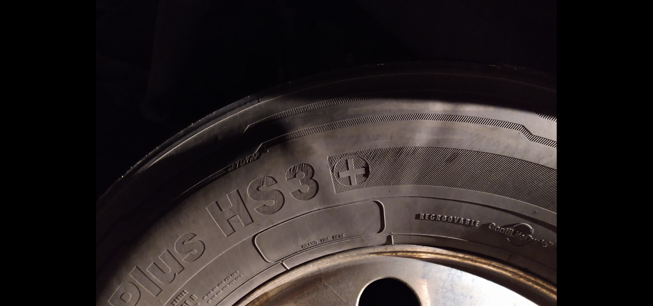

    What would cause this?
    Screenshot_20211013-200620.png It has smoothed out and you can hardly notice that it's there.
    I slip-seat so I'm not sure if its a defect or someone plowed intoa curb .

    i seen this before on my tires. never had a issue. it wasnt a v shaped, just a line

    Somebody hit a curb or something to break a sidewall belt. She's gonna blow!!!

    someone curbed that tire. i can see scratch marks.
    broken belt inside, get it replaced NOW.

    Hope it's not a steer tire,,

    Not necessary ...have one of my tires like this for over 100k ...not v though

    If it goes in its a belt overlap and normal. If it bulges out, its a broken belt and will fail. When, no one knows, but it will fail.

    Edit, if its soft like its full of air, you could have a air leak from inner liner to casing. Still will fail.

    No way I’d drive with that. Could blow any time. I would think DOT would pull it out of service and give the driver a ticket.

    It is.
