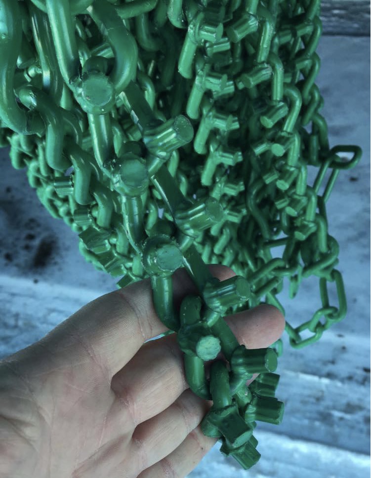

    Those are the only chains worth buying IMO. Luckily in these parts they don't force you to chain on dry pavement.

    I recently had to buy a set of chains for my new truck and decided to go the "cheaper but they look ok to me" route with Quality Corp 7mm cam link chains, at $150 per pair. You can find them on Amazon, but the same guy/business who seems to be the major retailer of these in the US has an even bigger presence on ebay. And a 5 star reputation there. Or maybe you can get them at a better price at some of the brick and mortar outlets mentioned earlier in this thread?
    I did look at Pewag chains for close to 2X the price, and some others for even more than that. But I've decided that, as an O/O, I'm going to subscribe to the policy that if you have to put on chains, you're likely doing something wrong. And will actively avoid going anyplace where I actually have to use them. However I do sympathize with company drivers, who are often given much less choice about when and where they are going to drive.

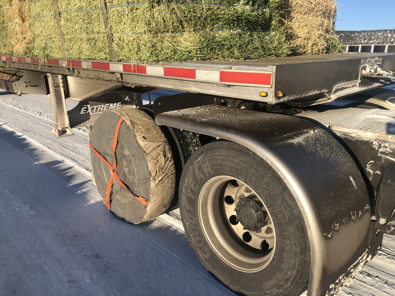

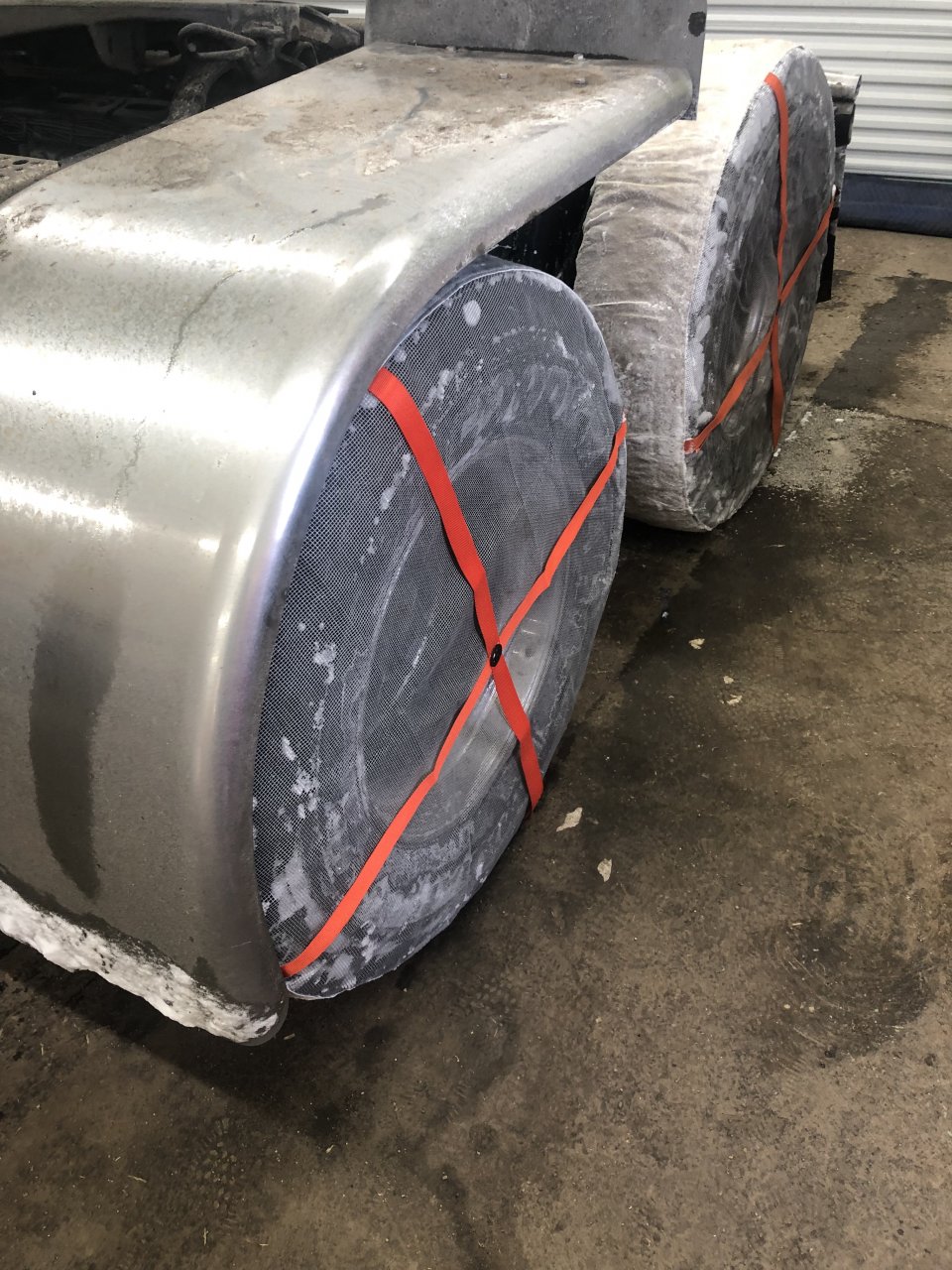

    I’ve had a set of Sox for like 5 years now. I’ve used them a few times on the road and 2x to get around in parking lots. I don’t generally run in areas that they are required so mostly just to be legal. On the plus side they are light weight and clean. Worth every penny in my opinion. 6749168D-9732-4AB8-84BA-D16348041236.jpeg 2ECC84C3-7F18-4BB4-BF21-EC6882868929.jpeg If I drive i had to throw iron all the time in the winter, 1. I would get some real chains, 2. I would do something different for a living.

    if you ever happen to tear up your sox and rip holes in them. dont throw them away . they work as great edge protectors under a tarp for sharp stuff. you can stretch them over corners and other stuff. that is what my sox are doing now. good to see someone got more use out of them then me ! mine were retired to edge protection duty after a couple uses.
