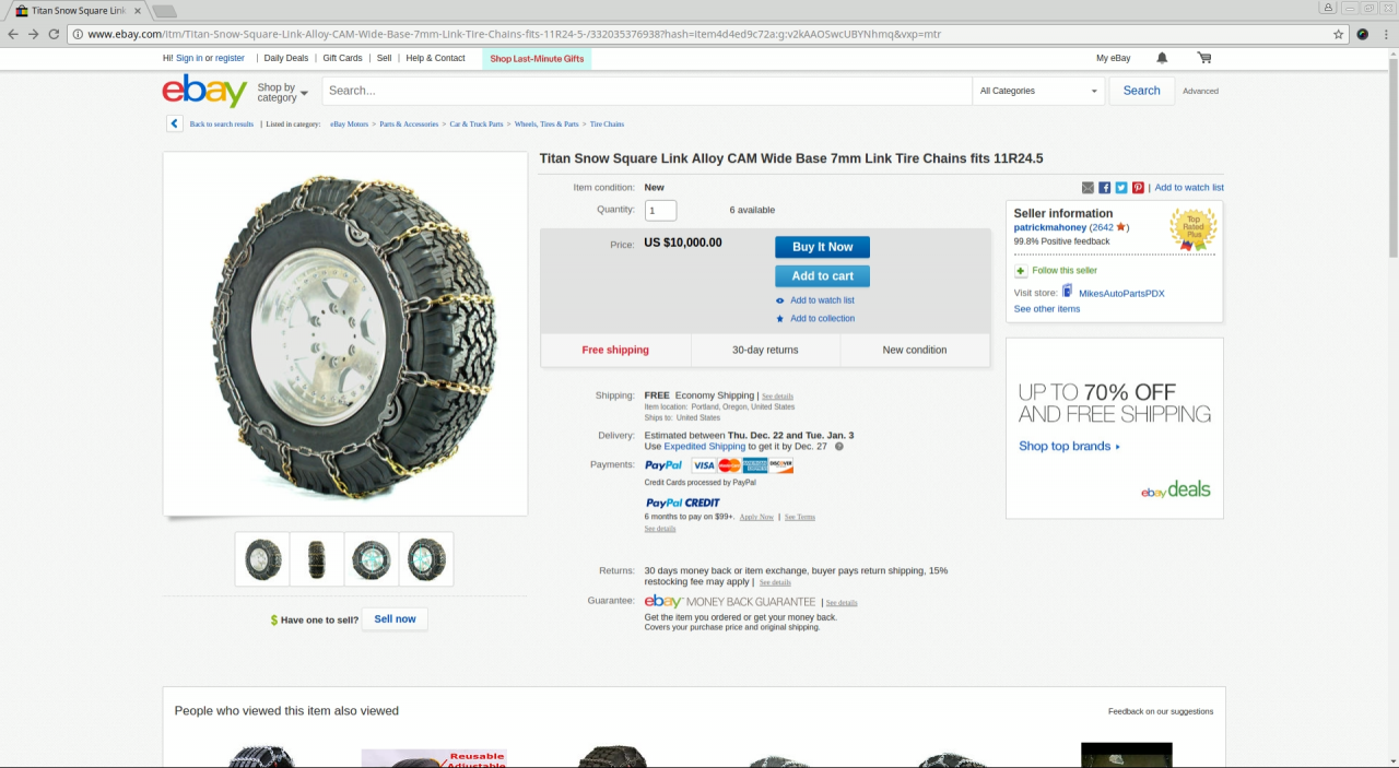

    These are a real steal...
    skellr and Getsinyourblood Thank this.

    Never ceases to amaze me the critical pricing and copy mistakes people make when posting to eBay and similar sites.
    flatbeb mac Thanks this.
