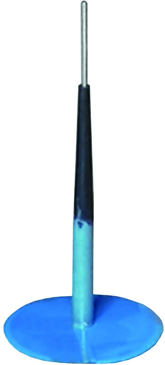

    My personal record for most plugs in a hole that I could get to hold air is 4. That was a creative morning.
    I don't like to use the plugs on steer tires though. Much prefer the proper pull through boot and plug style for the important axle!
