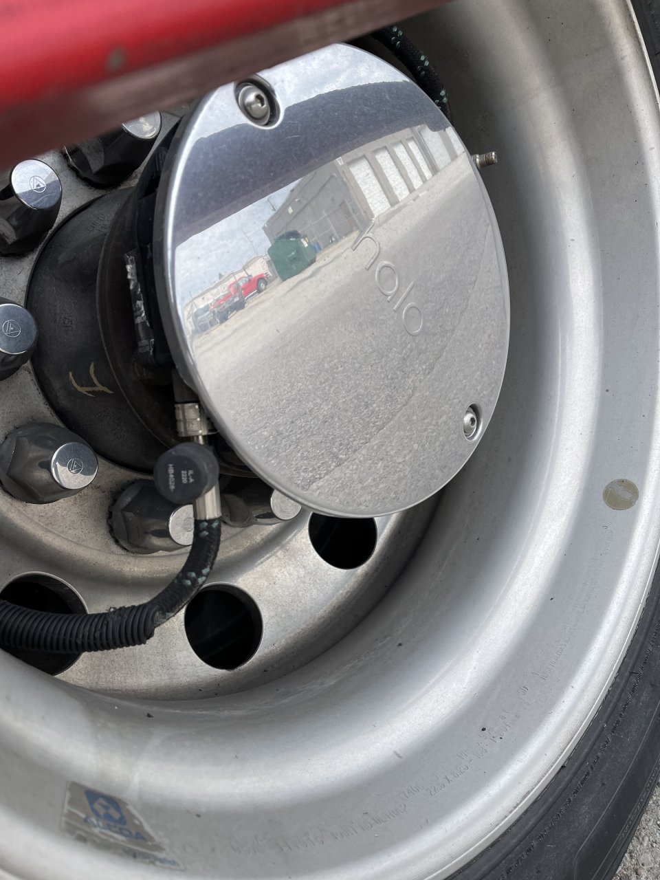

  7. Banker
    Banker Road Train Member
    4,139
    12,173
    Aug 19, 2012
    503,000 miles on mine and no screw ups.
    AperiaTechnologies Thanks this.

  9. Banker
    4,139
    12,173
    Aug 19, 2012
    Indiana and Ohio salt heavier than the actual snow accumulation many times. Halo are like any item requiring some occasional maintenance, if you don’t tend to it they could eventually be a problem. Check the bolts and hose connections occasionally and that is the extent of maintenance for them. I do my best to perform proper preventative maintenance and therefore I tend to have less problems. If a fleet does this at every service I don’t see what issues they would have. It certainly beats running around with under inflated tires.
    krupa530, roshea, Siinman and 2 others Thank this.
