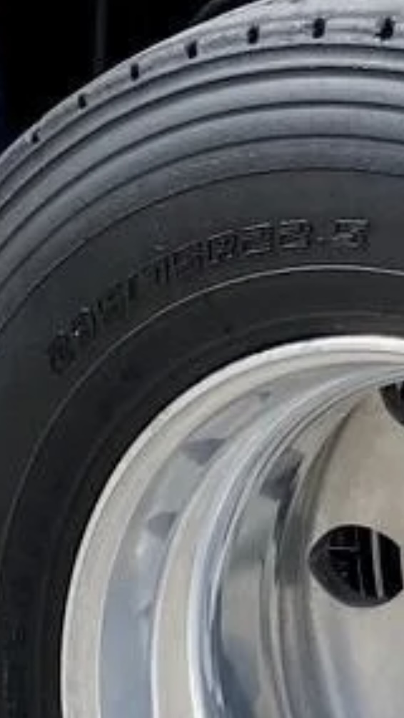

    IMG_1230.jpeg IMG_1229.jpeg Hey all. Thanks for reading. Ive got a question and, i gotta be honest, i feel stupid for asking this. But i'm confused ah right now;
    When it comes to commercial-truck tires, can 295/75r22.5 tires go on a truck when the truck-info sheet on the doorframe says to use 275/80r22.5?
    Im looking at a truck-for-sale listing. The doorframe says to use 275/80r22.5 but the truck currently has 295/75r22.5 tires. Are the 295/75s the wrong-size? Or can they be used (assuming all the tires are the same size)?

    Yes you can put on whatever tires you want. Those tires are practically the same exact things

    The 295/75 has a wider aspect ratio than the 275/80, but I think they are both the same circumference. Meaning, the change is fine and won't cause any problems. The wider 295/75 is probably better in most circumstances.

    80r is just a bit wider than 75r. Often used in RV’s I believe. I’ve ran them on my trailer a few times, alongside a 75r.

    One of us has it backwards. Probably me. I’m always wrong. Lol.

    The aspect ratio of a tire is the percentage of width to height.
    An 80 is a very tall and skinny tire while a 50... well, look at a sports car tire size. Short and wide.

    I wasn’t just wrong.I was really wrong. Only thing exactly the same IS the width.

    Looks like your speedometer and tach will read 2.9% lower than it would with the original tires. So at 69 mph on speedo your actual speed will be 71 mph, if it hasn’t been recalibrated.

    Taller aspect ratio; not wider.
    Aspect ratio, or sidewall height, is a percentage of the tire width.
