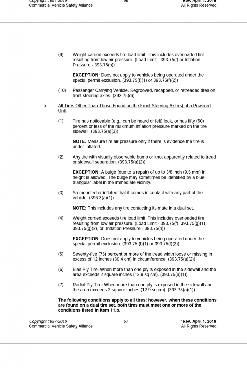

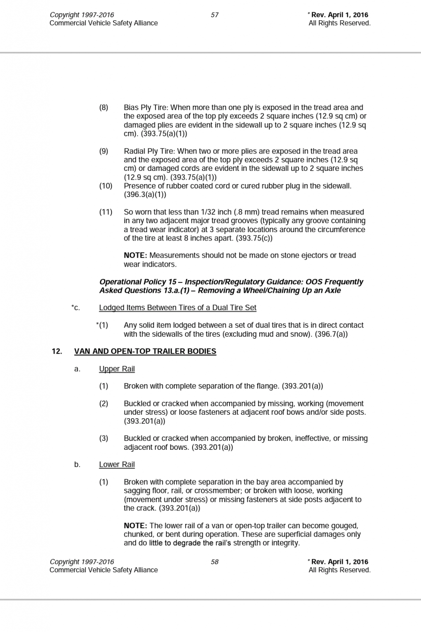

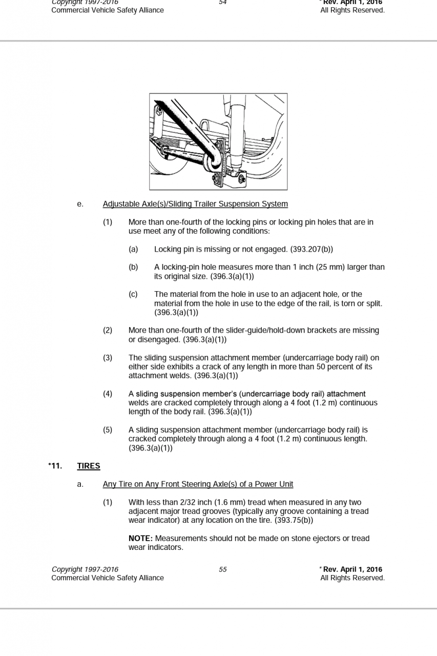

    §393.75 details the "minimum" to avoid tickets or warnings. OOS gives a little more wiggle room. For example, less than 2/32" tread (4/32" on a steer) at ANY point along a major tread groove (not including wear bars) is good for a ticket or warning, but unless you're 1/2 that measurement on 2 adjacent tread grooves, you're not going to be OOS. As for missing chunks of tread, that's spelled out in the OOS criteria as well:
    Screenshot_20180502-150232.png Screenshot_20180502-150238.png Screenshot_20180502-150250.png Screenshot_20180502-150255.png

    §373.75(a)(2) prohibits "any" tread or sidewall separation...but OOS requires 75% of the tread width or 12" chunk along the circumference of the tire.
    OOS has very specific requirements...and the defect either meets them or it doesn't. If it does, you'll be put OOS. If not, it's up to the officer whether to issue a warning or citation.
