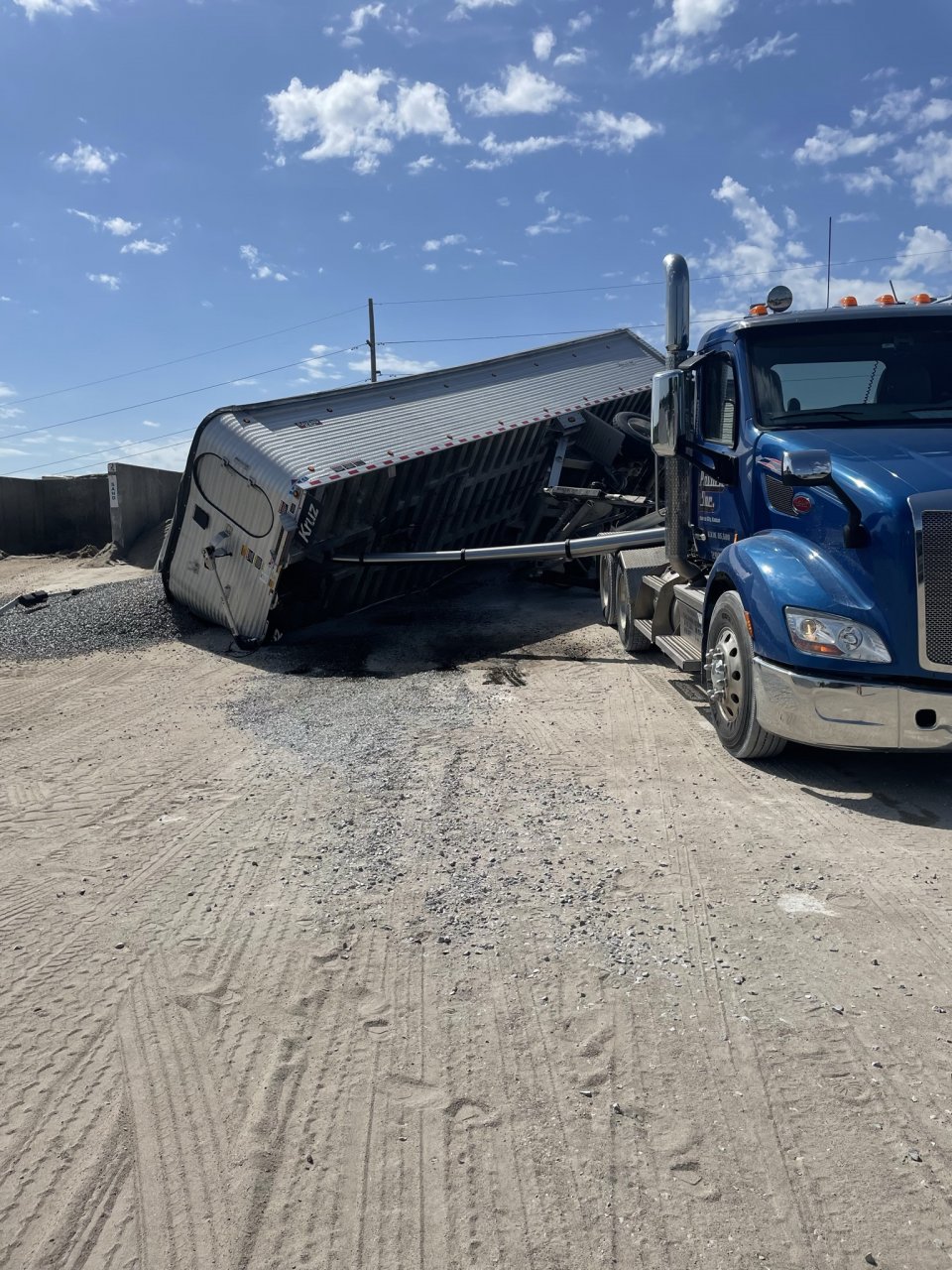

    It does take some getting used to standing a trailer up, and honestly everytime I dump a frameless I get that little bit of “oh boy here we go” feeling. But that’s what makes it fun. A full frame is a lot more sure footed that is certain. However they are heavier than a frameless. And if you get stuck you can’t “caterpillar” yourself out, you’re just stuck. Also, if things go south in a full frame and it goes over, it’s probably taking the truck with it. Violently. If a frameless tips the draft arms are SUPPOSED to break away, and not take the truck with it. As shown in Exhibit A.

    Yes a full frame is more stable. With a frameless ya gotta make sure you're level when ya dump but imo there lies the challenge and the rush of it.
