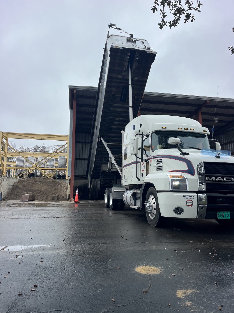

    A little cold patch to downtown Orlando to wrap up the week :) IMG_1196.jpeg
