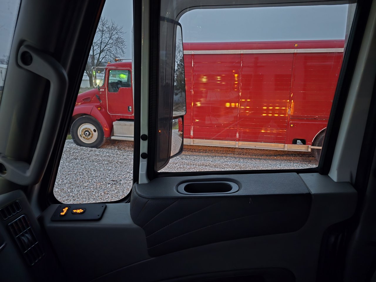

    So yea i got fooled up at salisbury. That gravel patch off to the left. While i was unloading a fully loaded beverage truck parked there (i know because he was opening the doors and looked to be a shift change) and then left before another came and parked. And i was driving fine on the gravel at the edge so i decided to turn through it....and sunk.
    Le sigh. First time in 7 years ive managed to truely stuck stuck a truck lol.

    Yea dude that would be easy to do there. I had to lock it in by that tree cuz I was all ###### up and trying to miss their pallets in the parking lot and trying to Austin Powers myself around it. It was cool meeting you today, like you said it was nice putting a face with a name!
