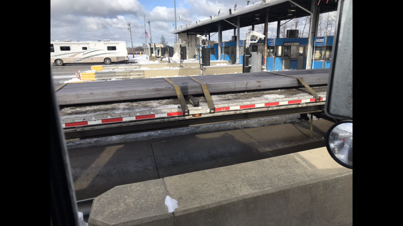

    No, there’s nothing wrong with straps on steel when it is loaded correctly. Pulled up beside this guy at the toll booth, there was gaps between these 4X4 steel bars which obviously means “nothing” but gravity was keeping it on the trailer. I see so many using straps on sharp corners of steel, then wonder why the strap is damaged!! @peterbilt_2005 pretty much said it best.....

    So how would chains be any better in that scenario?

    Chains nor straps either one is good here with open spacing between the steel bars. poor load job and driver obviously didn’t speak up. One advantage is belly wrapping to help pull it together, very few do it that I personally see out here. Chains last longer than straps on edges when not protected by a edge protector.

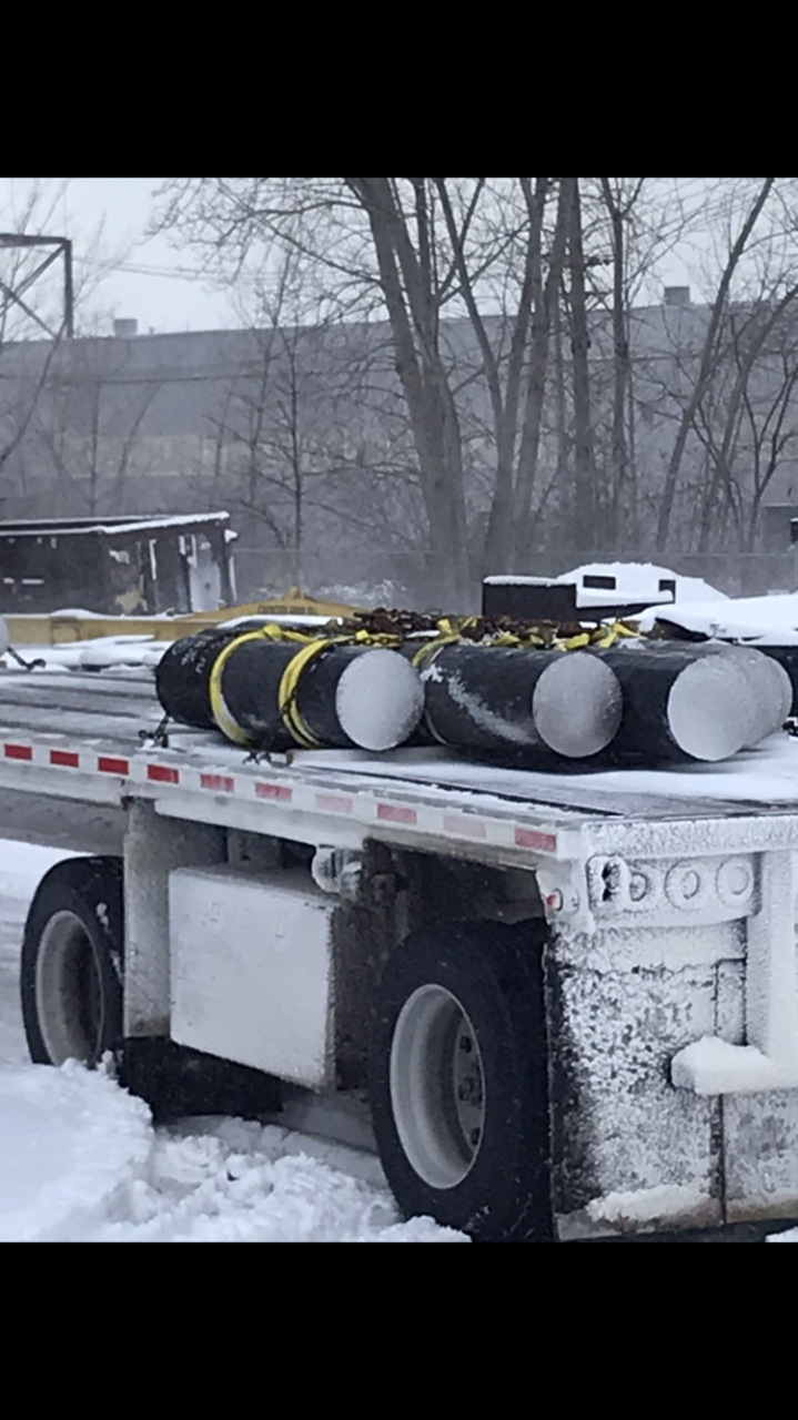

    This guy for example, loaded and unloaded around him quite a bit. Never seen a 3/8” chain on his trailer all 5/16”. Never seen him belly wrap a load although it’s actually a requirement here to have at least one chain belly wrapped per bundle. Usually one chain and one strap and he is gone!
    A round like one of these is what killed a woman just 9 miles from the plant..... 9 MILES!!!!!! That’s as far as one driver made it before his load came off the trailer, went over the bridge and took a woman off the back of her husbands motorcycle. Once again what @peterbilt_2005 said stands true.... flatbedding is a skilled job like it or not.
    Just because a guy knows how to start a dozer doesn’t mean he is a operator.:)
    I was hauling steel before the owner of that flatbed pictured here started jumping ball to ball to keep from getting shot into the honeypot.... but he knows more than I do, done seen that so I kept my thoughts to myself. :cool:

    I haul big titanium rounds, 15-20k each, alot of guys wrap them but I don't, I use J hooks omin my tracks that are between the center track and outside track....it makes the chain a short pull and tight to the sides.
    I dont like the wraps on the rough titanium, they never get as tight as I'd like them to.
