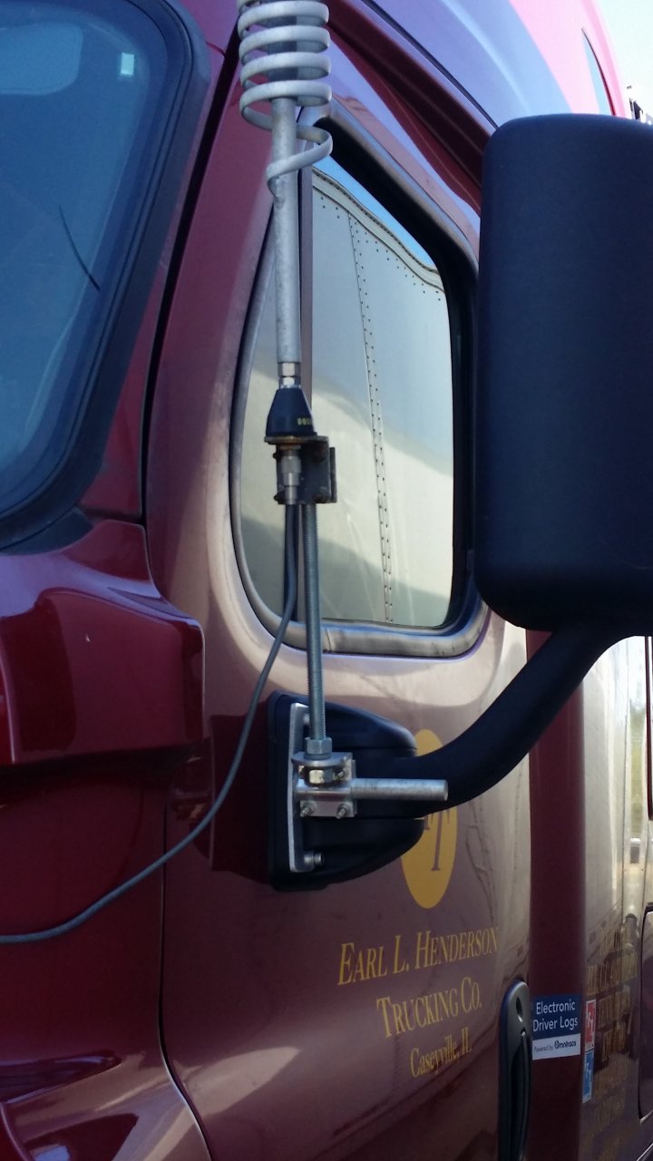

    looks like a k40 antenna ??? or a funky made I mean monkey made
