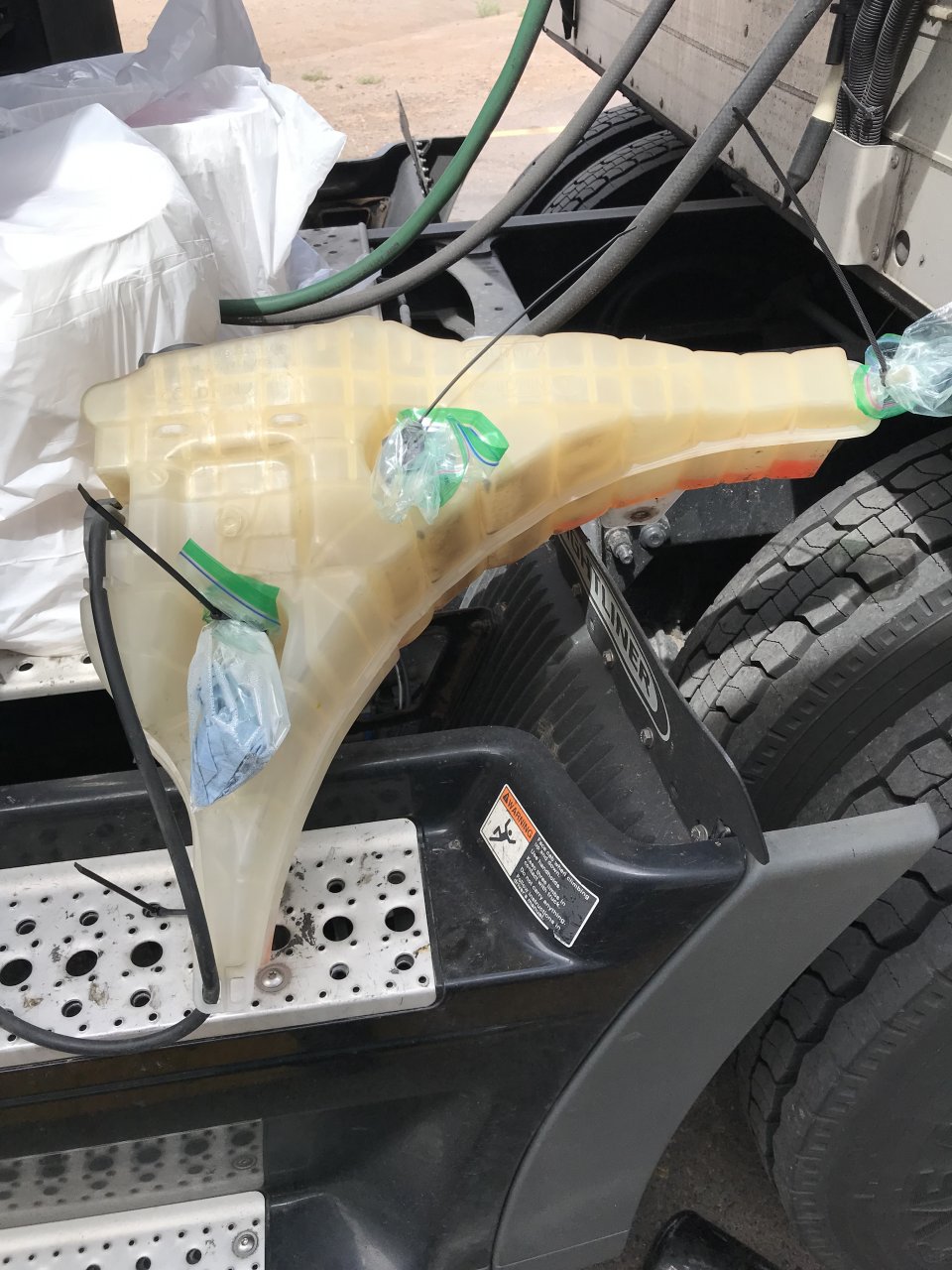

Torque Spec for Plastic Coolant Reservoir Mounting Bolts?
Discussion in 'Heavy Duty Diesel Truck Mechanics Forum' started by PE_T, May 12, 2019.
  1. PE_T
    PE_T Road Train Member
    This is on a 2014 Freightliner Cascadia DD15. Reservoir is made out of plastic. Two bolts are 1/2 inch and bolt onto the top of the radiator. Another two bolts are bigger at 5/8 inch and 15 mm and bolt onto a frame.

    I changed mine last year. Not sure of the torque. I just snugged them up tight by feel. It is plastic, so you can only go so far. But the design of it doesn't rely on the fasteners to hold it from falling off, they just keep it in place so it doesn't move around.

    What sizes are the treads of those bolts. I assume you wrote the sizes of the sockets or wrenchs you used to take them off. Make a trip to a local ace hardware or Home Depot to find that out. Metric or standard??
    PE_T Thanks this.
  9. PE_T

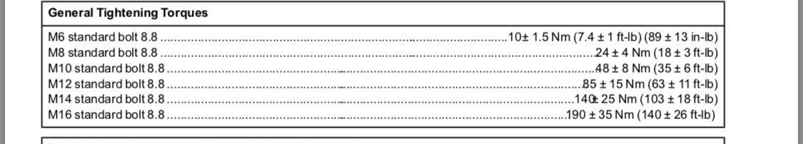

    I measured the bigger bolts (5/8 inch and 15 mm) and both are about 9.1 mm in tread thickness. I went back to the torque spec on my truck airbags based on tread thickness and converted it to my bolt thickness, and it shows 15-25 lb•ft.
