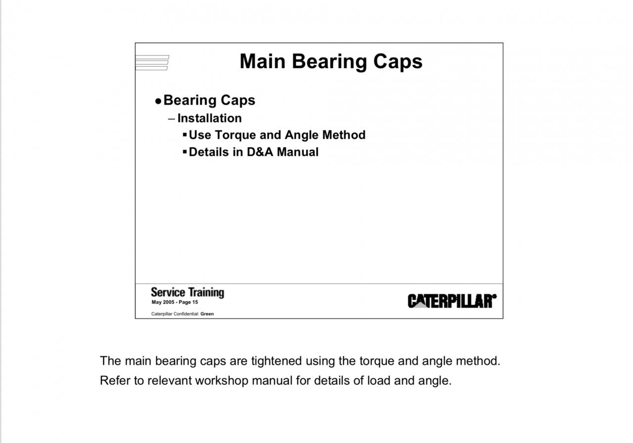

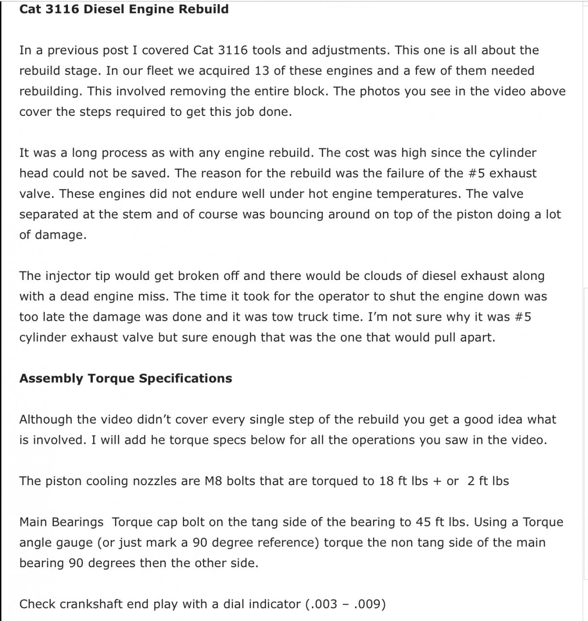

    6732F5A2-833A-4320-B849-7FA23AC61C96.jpeg B4A88338-D818-4D1C-A929-90C6755983CB.jpeg B4A88338-D818-4D1C-A929-90C6755983CB.jpeg All though I respect everyone’s opinion in this thread and I am not looking to bash anyone’s opinion there are many cases of engine manufacturers using the torque angle method of tightening main bearing caps including
    Caterpillar.

    From the reading I've done so far, I get the idea that the torque angle method is more specific to the fasteners being used than it is to the engine manufacturer. For example, if one were using brand new fasteners of a type that were meant to be torqued to yield, then it should make no difference at all to the engine. I could be wrong, but I'll continue to research the matter.
    Thanks again for the info! It's what I was looking for when I made my original post.

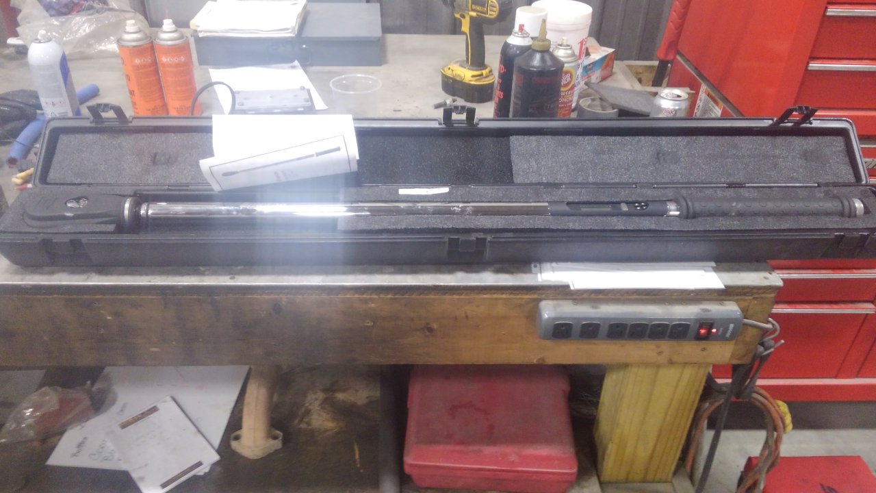

    That's the one I own, and if I did mains on a Series 60 and would pull it to published torque setting of Detroit.

    Does it measure angle?
    'Scuse me... I see from your post that it does.

    Yes it does. Use it mainly for head bolts.
