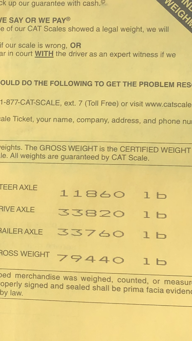

    6FC12ED0-2131-4028-A22D-DDD9F8E02870.png F341ED4C-A0A3-4F2F-A1A8-A81F3B7F02CC.png I’m carefull not to show up with a tare ticket, low on fuel. This load was supposed to be 45k. It was actually 44,360. Trucks 20,000, full of fuel, Trailers 15,500, it’s a heavy paper spec 53 dry van. I can still scale 45k, if needed. My last Trailer, was about 800 lighter. Standard spec, w/ aluminums, I could get 46k, when needed, hauling watermelons by weight. You should be OK, with most loads, up to 45k. Reefer? Depends on the weight. Friend of mine, 379 w/ Cat, reefer and 45k is always 800-1000 lbs over
