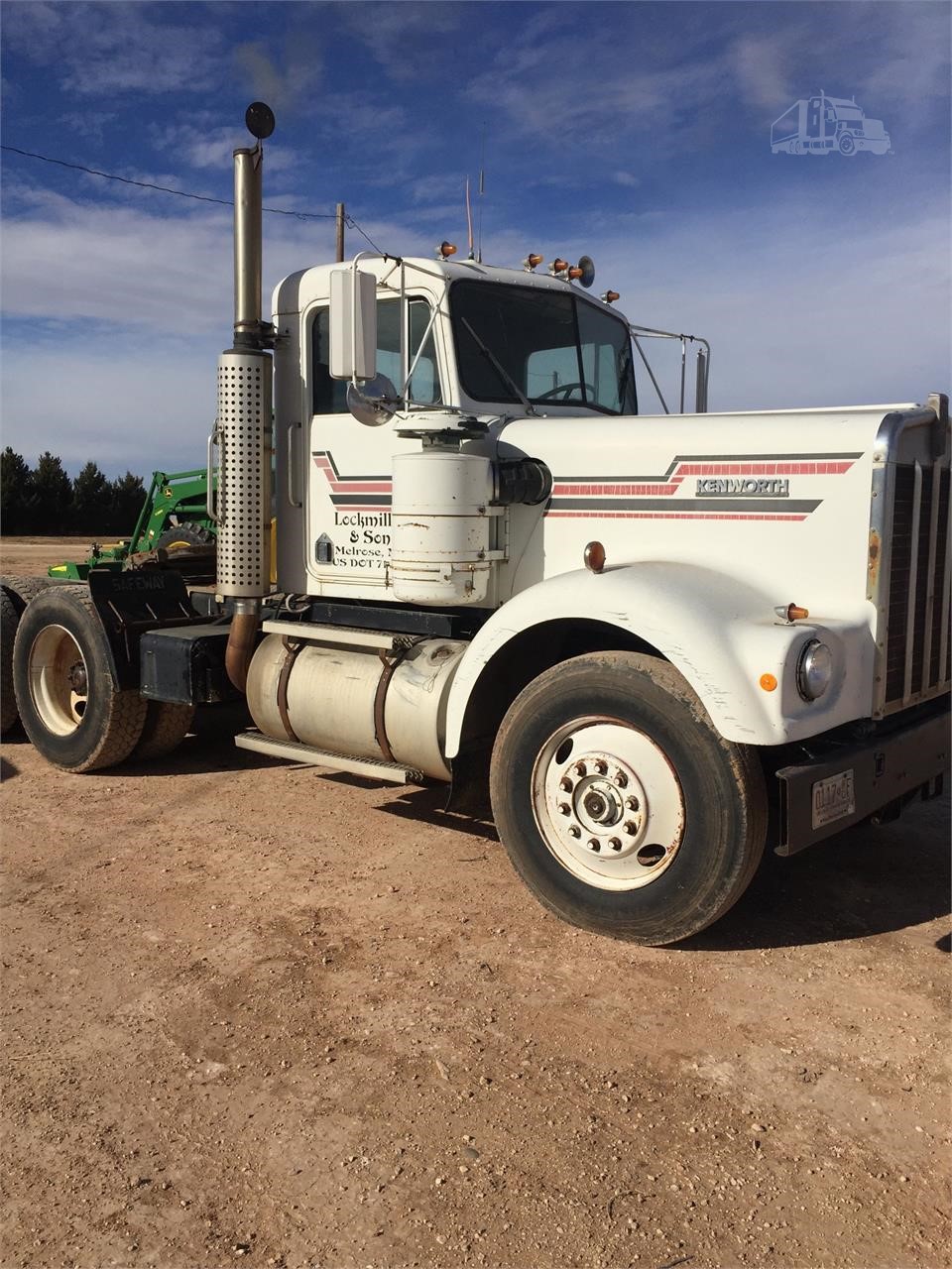

  8. ramirezbrandonc
    ramirezbrandonc Bobtail Member
    26
    25
    Feb 1, 2018
    Santa Fe, NM
    KW2.jpg KW1.jpg KW2.jpg I just ran across this posting right after buying the truck pictured. I was surprised to see it scale out at 15,900 LBS. Granted, that's not a true curb weight; the truck has fuel and all the fluids. That said I can probably knock off a couple of hundred pounds with a power washer!
    RockinChair Thanks this.
