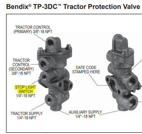

    Tractor protection valve should be at the back of the cab, follow from the gladhands to the other end of the air lines.
    What about the tractor brake lights, they are ok?.
    Your problem is most likely the switch is stuck.

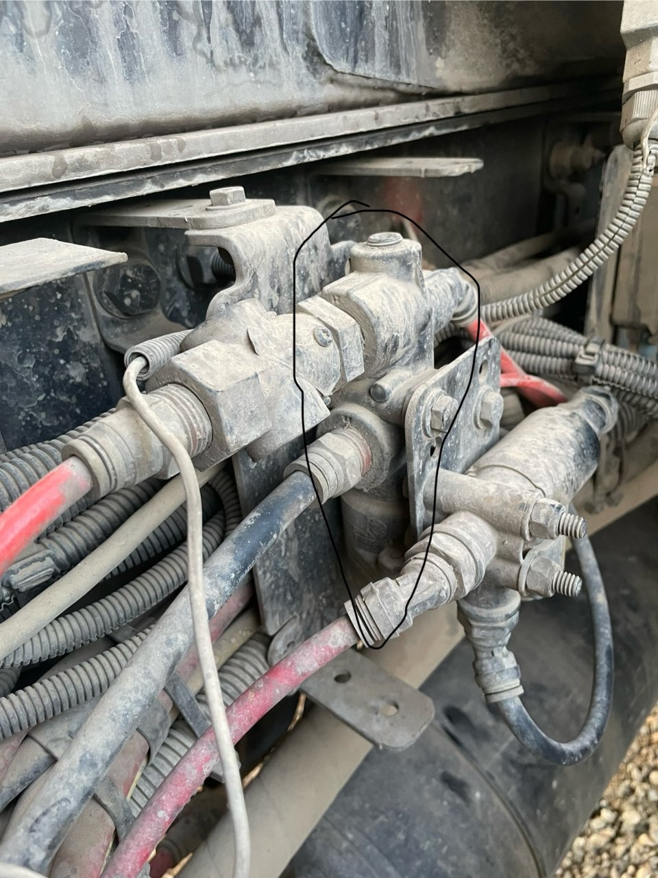

    yeah truck lights are operating fine. I found the valve but in your picture there is just 1 switch. Is there a second one for trailer or does truck and trailer run off same switch?

    Pretty sure this is the same valve you sent a picture of just has lots more stuff around it.

    "follow from the gladhands to the other end of the air lines." They end up at the TPV which should be what is in your pic. The switch there is for the trailer brakes. You could even disconnect it and see if the trailer lights go out or test at the trailer plug. There is a thumbs up/Thank icon if the response was helpful.
