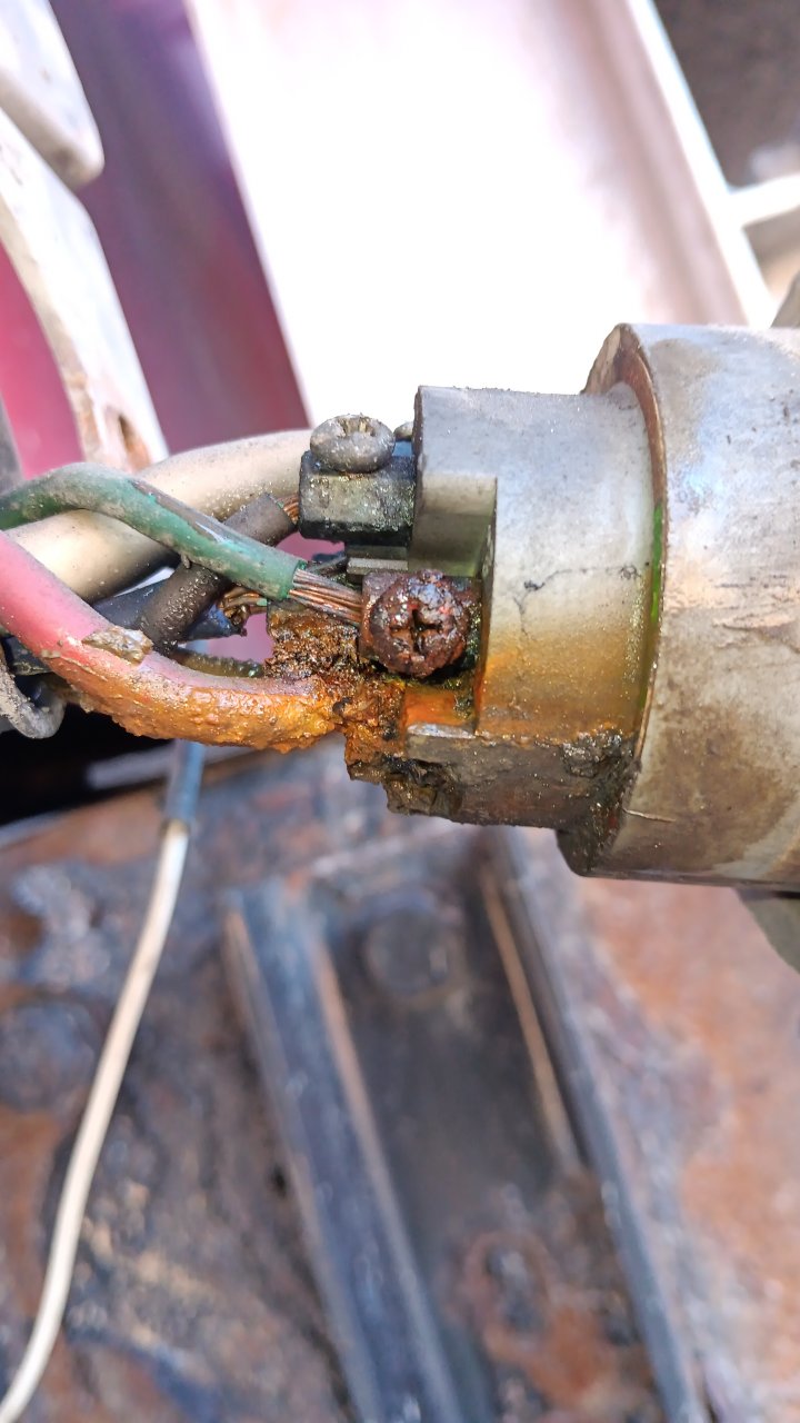

    I found the issue pretty quickly. It was at the plug on the rear of the sleeper. I guess it goes without saying that I've never had that one apart. Have a look. IMG_20250207_105359.jpg

    Easy fix! Nice. Looks like red was completely loose. I guess it was touching blue?

    Nope. All wires still where they needed to be. Just that rusted goop allowing current to cross over from the ABS post. I used a pick to break the connection and clean it out some. We'll enough to get by a dealership to pick up a new outlet (takes one with a large port for the huge ground wire) and make it home. Will clean it up and put the new one on tomorrow when the weather is nicer.
