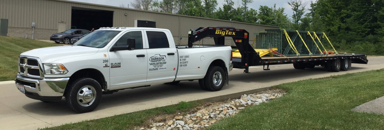

  9. I bought a Big-Tex 35+5 with mega ramps. With the ramps folded up I have 40ft of deck space. Being versatile in this industry is key. Being able to load a couple sprinter vans,SUV's or just a couple of cars so that you don't return empty is key. Something else I did was purchase a 5th Wheel hitch. I haven't pulled a camper yet, but did just take a call on one yesterday to take to Cumberland Kentucky. Pick what best suits your needs, but also keep in mind to think about other money making opportunities that are out there as well. Good luck to you! FullSizeRender.jpg

  10. mchlshltz
    mchlshltz Bobtail Member
    15
    2
    Apr 2, 2015
    Very nice set up.
