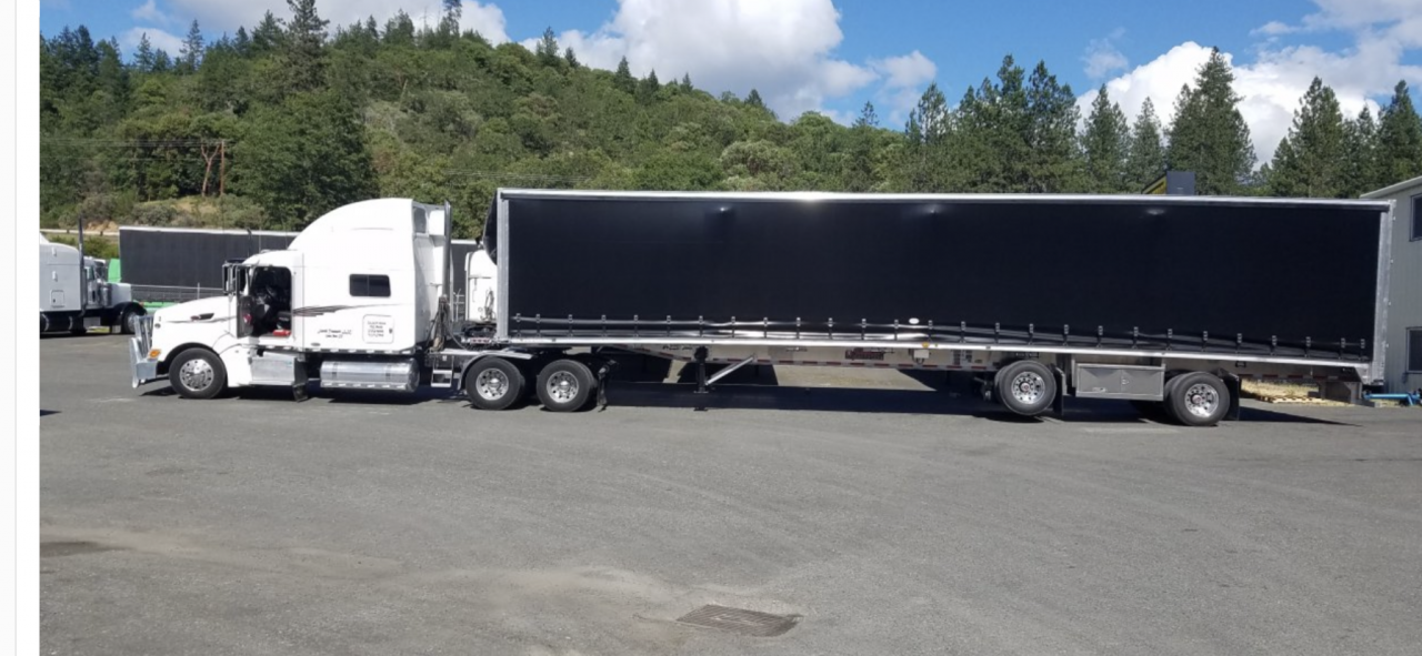

    I found a pic of my trailer with the axle up.
    Can’t really tell how many inches it’s off the ground though. I’ll measure it tomorrow

    mine is a 2017 Wilson 53’flat front lift. I used to run a Phoenix/Portland loop with this trailer but I’m local now with it. It would be a big hole to cause the lifted axle to hit the ground on the interstate. I only have the lifted tires touch in a turn where the crown of the road is larger than normal like sloped back country roads. Or driveways.

    Looks like about 4-6 inches to me from how the pic looks.

    But, an aluminum flatbed is arched and their deck height is much higher than a van, so the axles is going to be pushed higher up. Also, I’ve never seen a van trailer riding on as tall of airbags as the East flatbed I used to pull. That comparison isn’t equal.

    it raises 5.75”

    Thank you for update on that. So 2" would be a really bad idea in my eyes.
