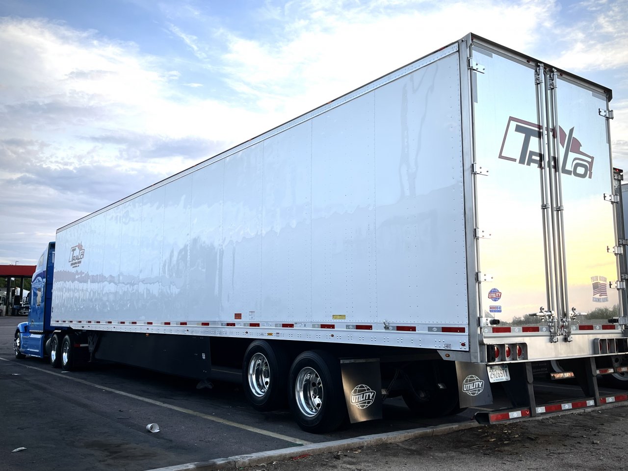

    I’m curious why they’re saying only 2 inches. Here’s the factory lift on one of ours.

    I’ll measure mine in the morning. Pretty sure it’s more than 2” but mine do hit the ground from time to time on turns. When the lifted tires do hit the ground they just spin so I don’t see flat spots.
    Siinman Thanks this.

    From factory how much do those go up off the ground?
