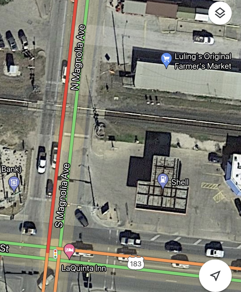

    In the video he’s up against the crossing arm on the right side. Did he cut through the gas station to round off the corner but the put him in the position of being between the crossing arm and the stop light with all the rear overhang?

    It doesn’t look as if there would be enough room between the pole and the gas station canopy. The beam of the trailer would hit the RRXXpole before the tip would clear that corner pole. And with the canopy on the right, you have less options.
    In tight situations, you can crab walk and do 3-4 point turns. That helps tremendously, but it’s a slow process.

    It looks like he cut through the gas station to me.

    Judging by light pole in previous pictures it appears your correct

    Hmmm, that’s what put him at the RRXX pole.
    @Rontonio, did you pull through the gas station? And how tall were your loads. We had to cut through a gas station in Oklahoma and one of the guys hit the canopy with a 55m blade that was 14’6 tall. And that’s worlds smaller than the ones you pull.
