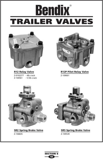

  4. snowman_w900
    4,418
    81,025
    Nov 25, 2010
    Also, theres so many different setups that have been used over the years, it could be any number or combination of valve.
    Here's a common one you see on older trailers
    This is a Bendix

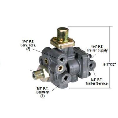

  5. henboy1
    henboy1 Medium Load Member
    332
    139
    Mar 26, 2011
    stockbridge
    This is what I have . 1 on each tank .
