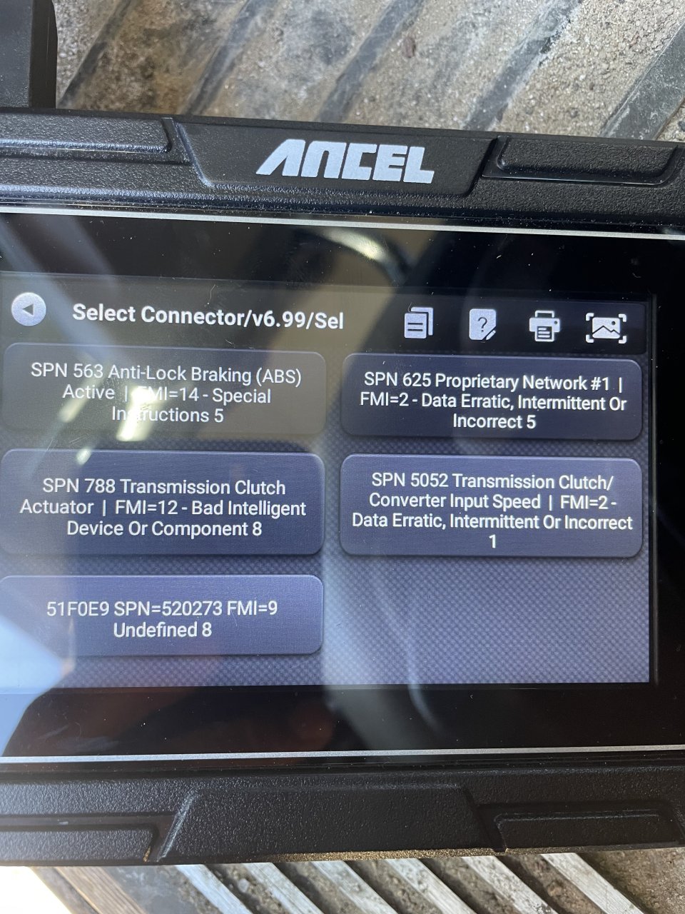

    Current code in picture 1, and previous/history codes are in the 2nd picture.
    Any idea whats going on?
    Transmission fault popped up while driving on highway, didnt want to upshift, barely made it to parking. After clearing the code - nothing, same issue, unplugged batteries waited 15-20 min, same code popped up.
    Truck didn't want to go in R or D, kept flashing F, auto.
    Went under truck after visiting this page:
    https://productinfo.serviceranger4.com/books/TRTS0940/lang/en-us/section/TS4080FC66Gen1
    Pushed the 2 connectors (3-Way Gen1 ECA Connector and the 1 above it) in a little and code went away - and was able to drive truck normally like everything was fine.
    What can be the issue here? Bad actuator? Bad clutch? Bad connectors? Bad fuse on the eca connector? Bad wiring?

    First thing to do would be to carefully check all the wiring coming from the transmission. Pull apart any connectors and look for corrosion. Even if no corrosion best to clean with a cleaner such as Deoxit and then use silicone dielectric grease before re-connecting. The Eaton website has complete diagnostic manuals that can be downloaded for free. The manual gives diagnostic procedures for each code. Almost 400 pages so too large to attach here. After checking the wiring and connections I would clear the codes and drive to see if any come back. May have just been a loose connection.
    The ECA was not getting the voltage it needs.
    The code in the 2nd pic, 520271 FMI 4. Your link tells what to check for that code and FMI 4.
    The ECA operates on a non-switched battery power supply.
    FMI 4 – Voltage Below Normal or Shorted Low:
    FMI 4
    • ECA Vehicle Harness
      • Damaged wiring between the vehicle batteries and 3-Way ECA Connector
      • Bent, spread, corroded or loose terminals
      • Wiring shorted to ground, shorted to power or open

    So how wasnt it getting enough voltage? It happened twice that day while I was driving, thankfully 2nd time it happened (as I was on the highway) I was close to my parking and somehow made it without stopping, barely.
    When I pushed the 2 connectors in a little the code went away. After that I went under again and unplugged both of
    them, cleaned them with an electric cleaner, put some dielectric grease, plugged them back in and secured with zipties.
    Did a short drive with it and everything was fine, no issues. Hopefully I dont get the same issuue again when Im otr.
