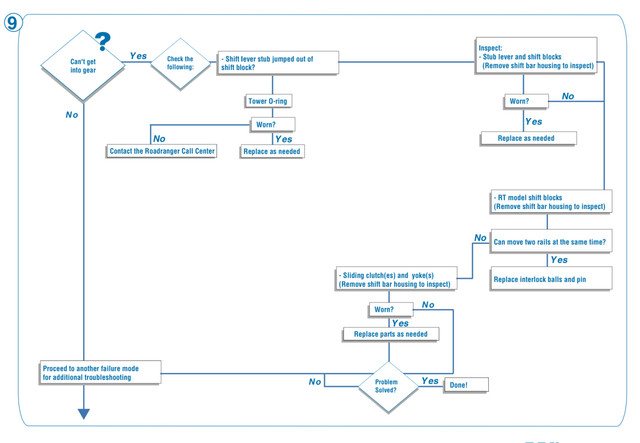

    So I have never had to slide my trailer axles (spread axle) because I usually tell people how to load. Low and behold I had to and had to to some work to actually get it done. In the process something fouled up on my transmission and it is gradually getting worse. Note I have a new clutch, flywheel, and clutch brake and it is adjusted and working properly. That said, it was working beautifully before trying to move my trailer axles and now I can’t get it into gear and it grinds while trying to do so like the clutch is bad. I can start it in low gear while the clutch it depressed and then I can get moving but it’s getting worse. When it stopped working it didn’t make any sounds or anything and just kind of happened. It actually started working again perfectly but once I parked it again to get a tire changed it went back to being super ####ed making me think it’s a quick fix and that it’s something minor. I had the tire guy under the truck and he said he heard some kind of grinding (what he said, I hear a ticking from the driver’s seat) when the clutch is depressed and the clutch brake is working like it should. Any help would be grand to fix my sweet dear 20 year old money pit. If it helps, it’s an 18-speed.
