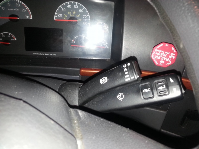

    Hopefully this picture thing works.
    Here's what I'm talking about tho. It's strange... The engine brake stalk is supposed to have a symbol of an engine on it. Mine has that plus symbol.

    The markings on the stalk are, in descending order, "Off," "Auto," and engine brake levels 1-3. The toggle switch on the end of the stalk is used to adjust the cruise brake described earlier. These are your engine brake controls. I agree that it looks strange, and it took me a while to figure out how it works. I went at least a couple of weeks without using the engine brake when I started in the Volvo, a bad idea going through mountains as a new solo driver. I'd encourage you to test out the controls in good road conditions with gentle declines and see what works best for you, but most of the time, I stayed in auto mode in good conditions and off in poor conditions.
