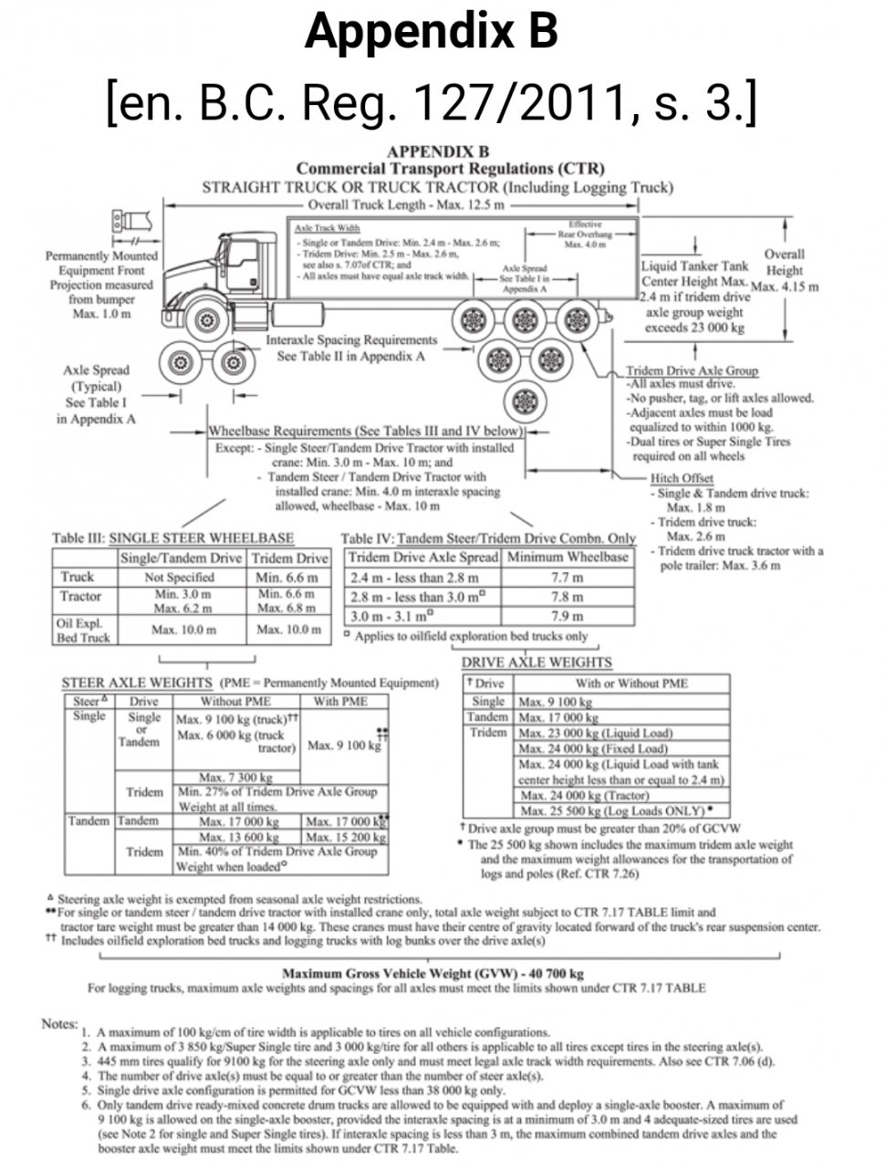

    What should the kingpin setting on your trailer be to get enough weight on your steers? I am using trailers set up for a tandem currently with pretty shallow kingpins and never have enough on the steer axle.

    I seem to recall my old man had the log bunk on his tridrives set at about 21" or 22" ahead of the center diff. That got him where he needed to be with his particular setup. I'd imagine a 5th wheel would be the same deal since its all about where the trailer weight gets transfered to the frame. May not be the same measurement with your truck though as it largely depends on wheel base and truck specs.

    I can barely get to over the center diff, part of it is neck length, i run into the back of the rgn or dolly legs.
    Thing has under 30000 km on it and the boss is buying a couple new trailers, i'd like to make someone else's screwup (ordering the truck) end up beneficial

    Sounds like you need a longer neck to get you some more clearance.
    Do you have plenty of room before hitting the back of the cab if you were able move the 5th wheel forward?

    Where are you running? I seem to recall in the BC regs that a tridrive must carry a minimum of 27% of the drive axle weight on the steer axle at all times. Screenshot_20191218-211417_Samsung Internet.jpg Here's the regulation I found.

    Alberta, local construction company. I remember martin posting something about that awhile ago

    Yes i need a longer neck, yes plenty of room. I flipped the tandem jeep neck over and slid the fifth wheel forward one day. Had enough weight on the steers to turn. Took more room than the tandem truck with the tandem jeep to turn
