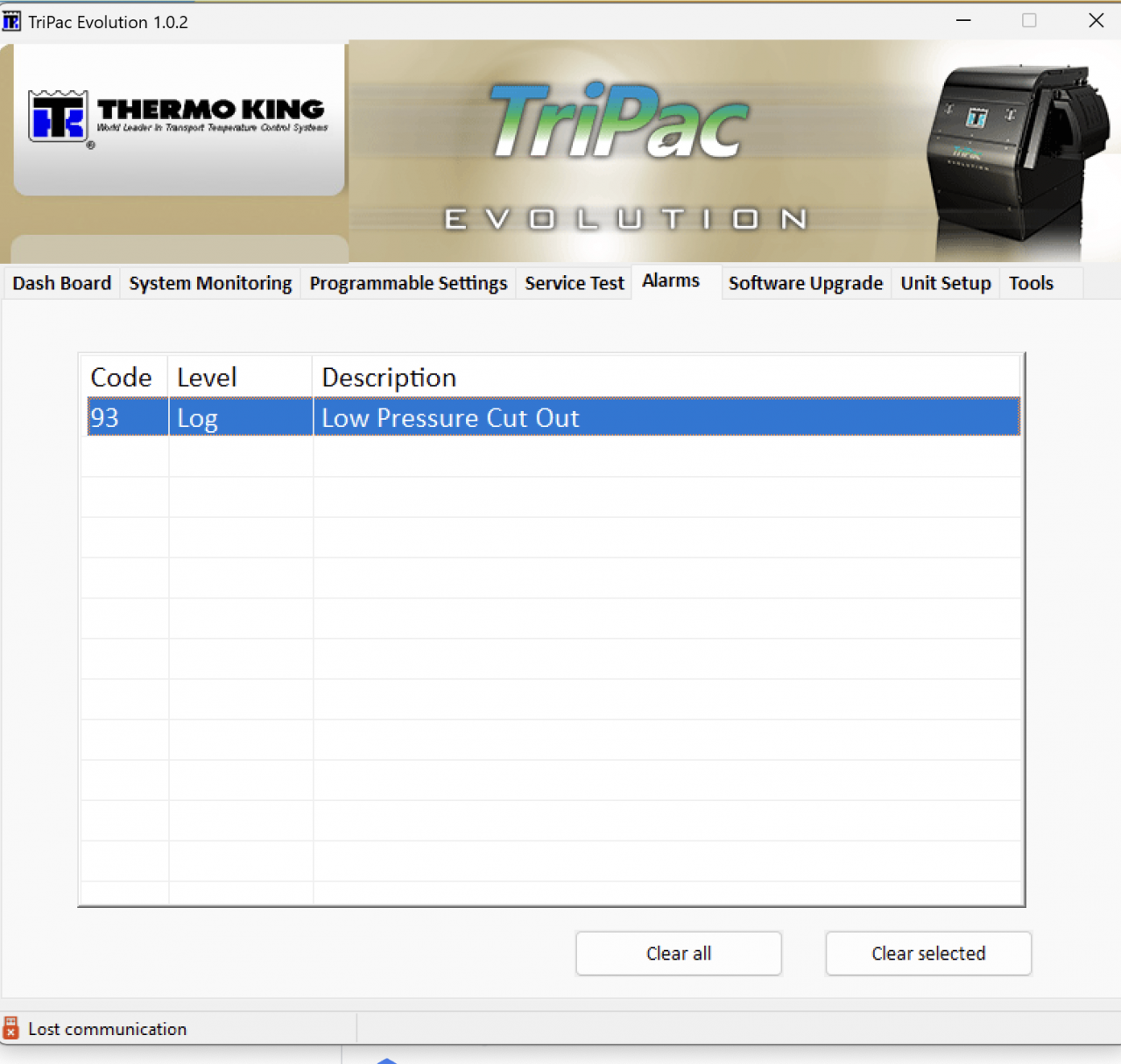

    Heyy!! My TK Evolution is throwing code 93 Low Pressure Cut Out. Do you know where that sensor is.. might try changing that. Please let me know and any instructions would be helpful. Thanks

    I'm getting that same code (93 Low Pressure Cut Out). I've changed the LPCO and also recharged the system but no luck. Compressor kicks on for about 10-15 seconds and shuts off. Did you ever get yours fixed?

    The High Pressure Switch close the Dryer yes if you remove it you will loose all your freon but the Low Pressure Switch inside de cab close the coil evaporator by the expansion valve have a core valve so freon don’t come out
